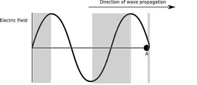

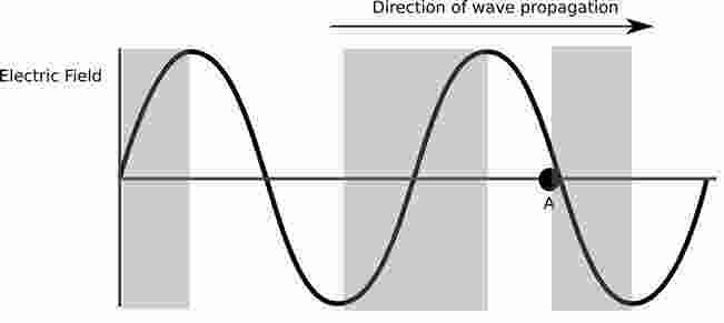

Here is an example of what I mean. Using the right-hand rule for magnetic field generated by a changing electric field gives the correct answer [the field is moving out of the page with a small magnitude]
In the figure below, the gray areas represent regions contributing to a magnetic field at A that comes out of the page. That is, regions to its left where the electric field is decreasing or regions to its right where it is increasing. The other areas are regions that contribute to a magnetic field going into the page.
But it seems all of that breaks down at the front of the wave. At that point you end up sometimes getting results the opposite of what you would expect (essentially the line integrals used to determine size/direction of EM field are missing part of their loops because the EM perturbation has not reached points farther along.
If you imagine that point A is very near the front of the wave, and thus that there is no electric field disturbance far to the right, then the increasing electric field to its left will cause the magnetic field there to go the wrong way, as it is not balanced by an increasing electric field to its right.
Normally, the change in an electric field near a point determines the magnetic field due to the attenuation with distance [which is why the gray areas to the left do not overcome the significant white area closer to the point.]
Is the solution here that the front of an EM wave has modulated amplitude? So the change in the white area shown is relatively small compared to the change in the gray area farther to its left? Thus allowing that larger gray area, though it be farther away, to cause a net magnetic field coming out of the page [i.e., the direction it is supposed to be going?]
That is my assumption, but I was hoping for some verification.

Your gray areas don't make any sense to me. If you have a plane wave propagating in the x direction and you take a snapshot of the electric field (in the y direction) over all space at a given instant in time then:
1) you automatically know the magnetic field (in the z direction) over all space at that instant in time.
2) you can use that information about the electric and magnetic fields to determine the fields at any future time.

What about them does not make sense?
If you wish to calculate the magnetic field at a certain point based on the rate of change of electric fields nearby (using Amphere's circuital law), there are certain points where the fluctuation will contribute a positive-z value to the integral and certain regions where it is contribute a negative-z value to the integral.
The gray regions simply show which is which.
For example, if the field is propagating as shown, then points immediately to the left of A have electric fields increasing in the positive-y direction, by amphere's law, that is going to create a contribution in the "into-the-page" direction (right-hand rule). So those regions are white.
My point is that when you do these calculations using the standard pictures given for E-M waves, the calculations give the wrong answer when done at the wave front, as shown in the second image, where it is assumed that the point at A has only recently been reached by the wave.

By the way, looking back at my original post, I do think the points raised there are still valid.
The gray areas represent regions where the Biot-Savart law (using displacement current related to the change in the electric field) yields a magnetic field at A in the 'out of page' direction. If the front of an expanding light wave looked like what is given in textbooks as the canonical representation of an EM wave, it would break the Biot-Savart law at the ends. In the second image of the OP, the Biot-Savart law would yield a magnetic field going into the page, which is the wrong direction.
First, the Biot-Savart law is an approximation to Maxwell's equations for the magnetostatic case so it doesn't apply for EM waves. Second, the Biot-Savart law uses real currents, not displacement currents (in the magnetostatic case there are no displacement currents).
