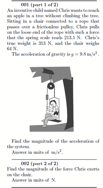

rodjav305
a=F/m
For part 1 I did this :
Mass of boy: 353 N/9.8m/s^2 = 36.020408 kg
Mass of chair: 64 N/9.8m/s^2 = 6.530612 kg
Then :
(36.020408 + 6.530612)a = 2(213.5)-353-64= 10N
a= 10 N/ (36.020408 + 6.530612) = 0.235012 m/s^2
I need help on part 2, any help is appreciated!

very good!
Now you need to draw a free body diagram of the chair, in order to calculate the normal force of the boy on the chair, OR, draw a free body diagram of the boy, in order to determine the normal force of the chair on the boy. You can do either FBD, whichever one you find easier to identify the forces acting, then use Newton's laws. Note that the acceleration of the boy and the acceleration of the chair are the same as the acceleration of the system.

It is a bit difficult to draw a free body diagram of the boy or the chair in this example, but nontheless, let's focus on the forces acting on the boy. His weight acts down, there is a tension force acting up on him, and the contact normal force of the chair is pushing up on him. The algebraic sum of these forces is the net force acting on him. Now use Newton's 2nd law, F_net =ma, where m is the mass of the _____?
Alternatively, you can look at the forces ating on the chair. Its weight acts down, there is a tension force acting up on it, and the contact normal force of the boy is pushing down on it. The algebraic sum of these forces is the net force acting on the chair. Now use Newton's 2nd law, F_net =ma, where m is the mass of the _____?

Lets focus on the forces acting on the boy, Chris. His weight (given) is pulling down on him, there is a tension force (given) pulling up on him, and there is a contact unknown normal force (N) of the chair pushing up on him. The algebraic sum of these forces (take up as positive and down as negative) is the net force acting up on him. Now use Newton's 2nd law, F_net =ma, where m is the mass of Chris, to solve for N, the normal force.

There's only one rope in the horse pull problem. In this problem, there are two rope forces acting on the child-swing system when you draw a FBD (Free Body Diagram) that isolates the child and swing from the pulley. This is not the case when you draw the FBD showing the forces on the child alone, since only one rope acts on him (at his hands).

If you are looking at the forces on the chair, then FT -Fgchair - N =mchair*a. You forgot the normal force of the boy acting down on the chair. If you are looking at the forces on the boy, then FT -Fgchild + N = mchild*a. Again, you forgot the normal force of the chair acting up on the child. FT is given as 213.5 N.
As a check, you can look at the child-chair system, where the tension force 2T acts up, and the weight of the boy and chair act down, solve for a using Newton 2 and using the mass of both the boy and chair (no normal force in this FBD since it is internal to your FBD of the system).
