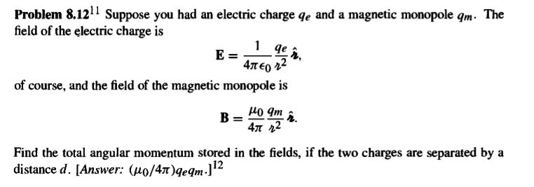

1. The problem statement, all variables and given/known data
I have attached the question as jpg to this post. Typing these were too time consuming and I uploaded the relevant sections as image files, thanks for your understanding.

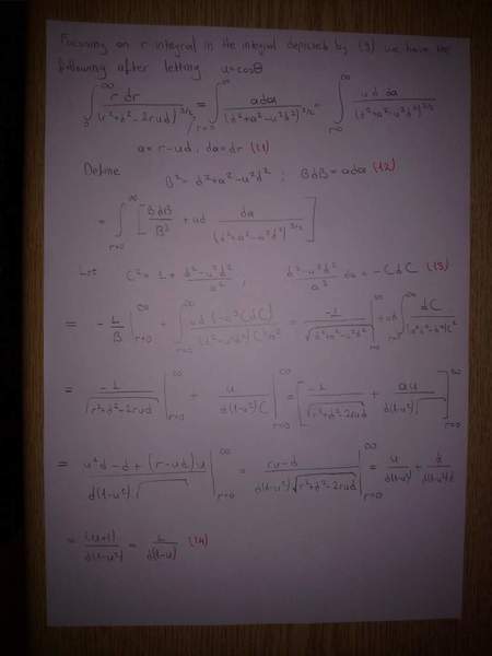

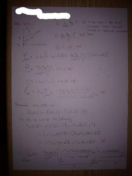

3. The attempt at a solution
These too are attached in png format.
I have found out that angular momentum density has two components, one in the z direction and one in the x direction. According to the books solution the x component integrates to zero but I was unable to verify this and I am highly skeptical about this topic. Any help would be appreciated. I have attached the relevant information to this post.

In constructing your equation (8), note that ##\hat{r}## will generally have a ##\hat{y}## component as well as ##\hat{x}## and ##\hat{z}## components: ##\hat{r} = (\hat{r} \cdot \hat{x}) \hat{x} + (\hat{r} \cdot \hat{y}) \hat{y} + (\hat{r} \cdot \hat{z}) \hat{z}##.
##\hat{r} \cdot \hat{x} = sin\theta cos\phi##, etc.
See what you get for the x and y components of the angular momentum when you integrate over ##\phi##.
