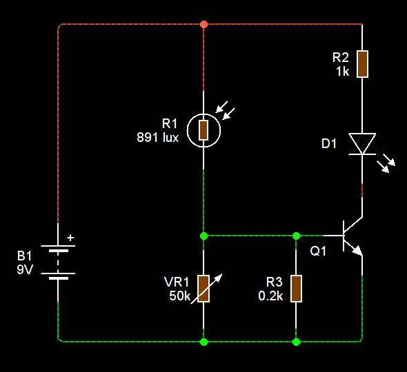

Then how does this alteration, adding the resistor between the base leg and the 0V rail reduce the region where its not digital?
  • Screenshot at 2012-04-19 11:08:13.png
Lowering the B-E resistor will reduce the sensitivity of the circuit, necessitating a more intense light for the change of state. This might be useful in a brightly lit room, or in sunlight, so that the ambient light does not affect the OFF state.
Like Jim Hardy said, if you really dig deep, everything is analog. It just depend on how you look at it. With your circuits, as long as there is no emitter resistor, the input that the circuit behave as analog in only a very small window, nobody use this as analog where you control the intensity of the LED. Any circuit that looks like this is only designed for on and off.
If you try, you can make analog circuit like op-amp to become a digital inverter. AND some crazy people in music electronics designed a distortion pedal for guitar using CMOS logic inverter gate 4049 and slapped on feed back resistor and use it as a clipping op-amp! It was so funny but it is on a selling product. The point is it can go either way if you try hard enough.
Don't get hung on whether it is digital or analog. Look at the application. No engineer in the right mind using the circuits you draw as analog intensity control no matter you add in more adjustment pots or what. You want analog, you put a resistor between the emitter and ground, then you have a wide window where the LED can be control from dim to bright.
