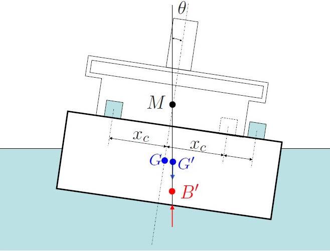

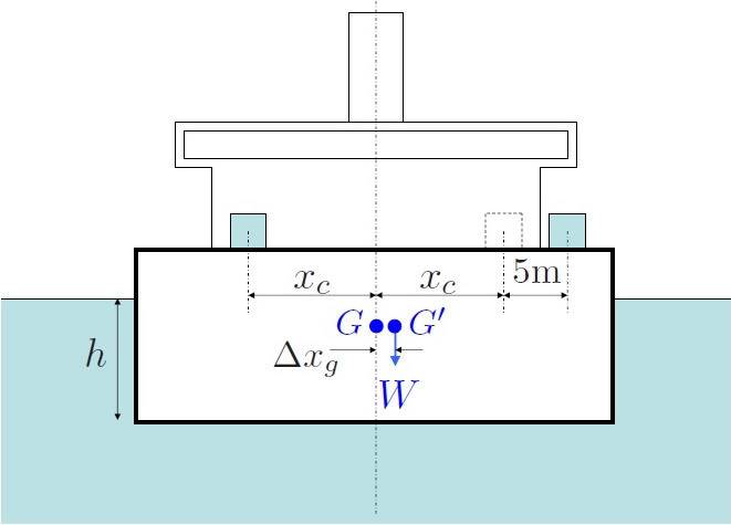

The ship was initially looks like this the mass of the ship is 5000 tonnes two heavy cargocontainers each of mass 73,370 Kg each
assume that the ship has a rectangular waterline area, with length 94.85m and width 12m
The question is asking the length of BG and hence find the length of G'B'
Ive been told that GM=47.7028(m) GG'=2.5(m) h=4.41154(m)(sink height) the angle is 3(degree)
What I've done was using the equation GM = I/V-BG then BG = I/V-GM
For the I/V part I = bh^3/12 from the textbook the problem is which value is b and which value is h?
Any one help
