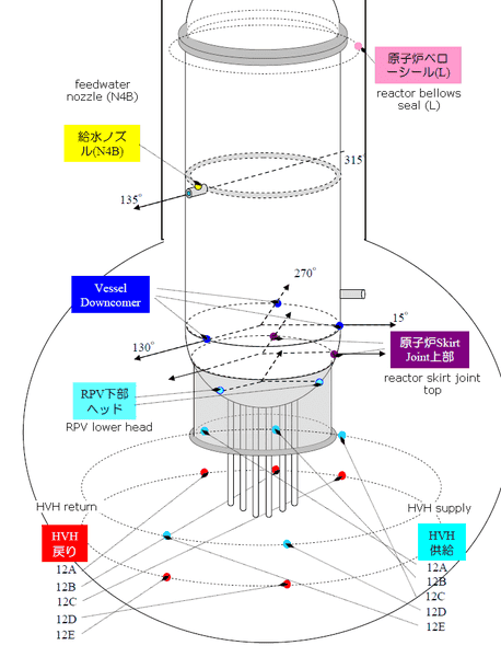

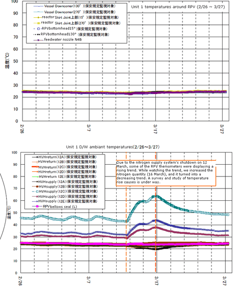

elektrownik said:
Unfortunately, after they discover that two water sensors and two pressure sensors in unit 1 were wrong we can't trust any data
i have faith in thermocouples so long as they're dry . Especially if they're wired right to the computer with no electronic doodads in between.
Pressures i have suspected ever since the explosions for when you drastically overrange a sense element you give it a "set" and it'll read high ever after.
Jorge's plots were real useful for trending but i expected pressures to be found reading high.
next couple days should tell about units 2 & 3.
Levels are subject to losing water in their sense lines, as when drywell gets real hot and instrument sense line heats up driving dissolved gas out of solution. So the gage reads in error by the height of any gas bubbles in its sense lines. They became unreliable IMHO as soon as depressurization began with no ventilation to drywell. Ever open a hot Coke?
that's why i spent so many hours staring at photographs looking for reactor parts..
Most computer electronics will start to act up after several thousand R which would be scores of Sv.
It'll be interesting to see how the Packbots hold up.
Time will tell.
To be fair they always made it pretty clear that quite a lot of the data could be wrong. We know for a long time that some numbers must be totally wrong, where 2 indicators disagree with each other a lot, or where values go up and down in crazy ways or show - values.
Aside from slowly getting a few more bits of accurate data as they install new instruments, there isn't all that much more that I am expecting in terms of quality data that will give us a clear picture. Personally the most illuminating thing I can hope for in the weeks ahead is the english translation of TEPCOs long analysis document. The one that contains the estimates of core damage that we already know about in detail, but also estimates for containment damage, where we have only seen a few internet & press reports & a couple of paragraphs of the document that I machine translated. Although I can't speak Japanese I can tell by looking at it that it seems to contain some interesting graphs showing not just actual pressure & temperature data that we know already, but also what they think the temperatures & pressures really were at various times early on. Sometimes this differs considerably from the actual data, and there are handy events labelled on many of these graphs, such as the moments they think core, RPV and D/W or S/C damage happened.
