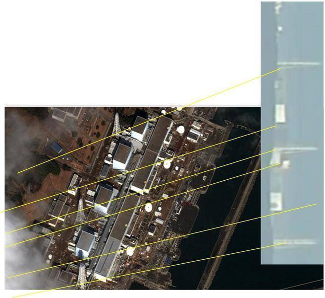

No answer has been posted to my earlier questions about the process of putting spent fuel rods in casks for transport. With two trucks out back for that purpose, one sans cask, and Unit 4 in shutdown mode, it would seem possible if not likely that cask transfer was in progress, though at what stage, we don't know.
Cask transfer was taking place at Unit 4 , even though the vehicles were parked outside unit 3
Look at the high res pics of unit 4 loading tunnel and you see a truck peeking its head out,
so in my opinion we can confirm fuel transfer (in or out) at Unit 4 was in progress

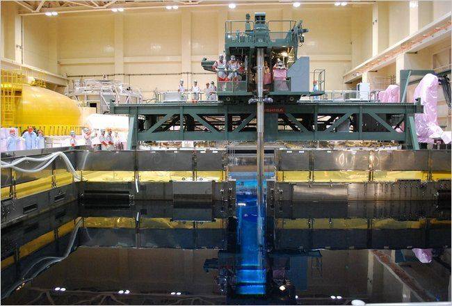

Maybe at both 3 and 4? Or maybe new fuel was going in and old fuel was going out? It would be interesting to know the exact procedure for both transfer of new fuel rods into the building, and spent fuel rods out of the building. It would seem logical to me that there might be a small accessory pool for cask transfer, as I have suggested earlier. At some point, the overhead crane has to hand off the dry cask to the wet operations of the FHM, and I doubt that means plopping a dry cask with new fuel rods into the SFP.
It would make more sense to put the dry cask in a small pool, pumped dry, then flood the small pool, then open the cask underwater, then transfer the new rods directly to the reactor core underwater. It would also seem logical to transfer the spent rods under water to a flooded small pool, containing an open cask, then to close and decontaminate the exterior of the cask before the crane takes it back for loading on the truck. Just guessing.
They would probably take every precaution to keep the overhead crane from being contaminated, whereas the FHM, or at least its mast, is designed to live with the high levels of radioactivity in the lower depths of the SFP and reactor core. I bet the mast rarely if ever comes completely out of the water.
It is pretty darned sure that the new fuel rods get nowhere near the spent fuel rods in the deep part of the SFP. The only time that proximity would occur is in the core of the reactor.
It sure would answer a lot of important questions if accurate drawings of the floor plans of the Fukushima Units 1-4 were available.

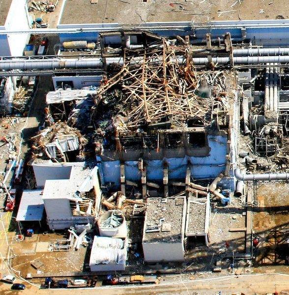

Hello!
My first post after reading this thread for last couple of weeks. I couldn't not to register after I looked at this photo.
http://www.reuters.com/news/pictures/slideshow?articleId=USRTR2KAAL#a=25"
Doesn't it look like whole top floor of reactor level is gone? Compare to this pic for reference where top floor should be.
http://www.reuters.com/news/pictures/slideshow?articleId=USRTR2KAAL#a=27"
In the first picture I don't see DW cap at all where it should be. Only big hole with steam coming out of it.
Also workers had some time after loosing all electrical power except batteries before things got dangerous. Couldn't they moved that big crane on top of reactor plug as precoution? If I'm looking correctly, east end of crane is still on floor it should be but west end has dropped one floor lower, becouse whole floor is gone.
I hope I'm helping...

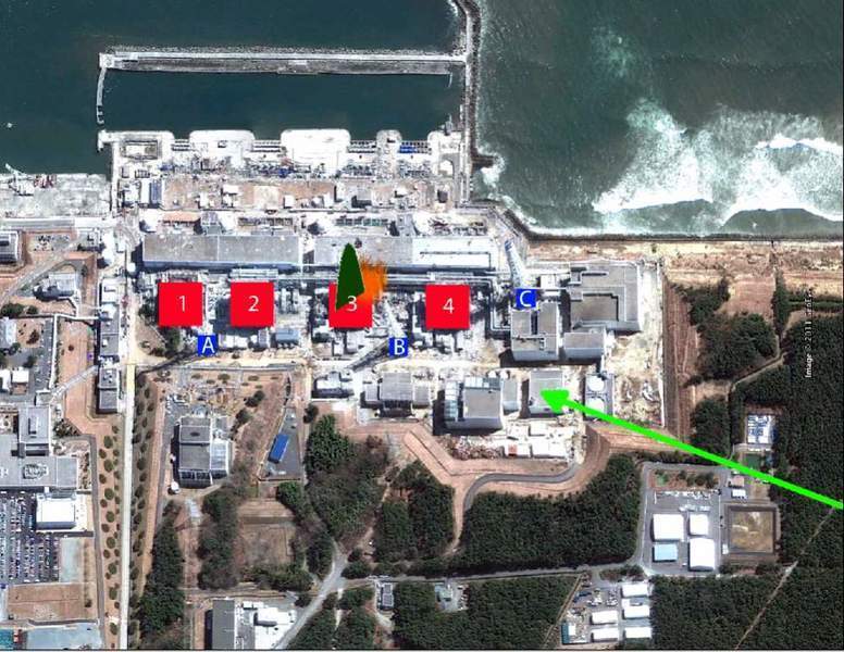

In this image there's an area labelled outlet intake, would it not be feasible to use this for some water storage? (after a little wall building)
If it's just TESCO workers running around with fire hoses and the like they're not going to achieve much are they.
They need the biggest pumps/helicopters/barges and tugs the planet can offer.
This is a world problem, and a big one...

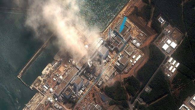

An additional 1,500 tons of radioactive water will also be released from the No. 5 and No. 6 reactors, after runoff was found flooding parts of their turbine buildings. There are concerns that the water could damage the backup diesel generators for the reactors’ cooling systems, Mr. Edano said. Water from these reactors will be released 300 tons at a time over five days.
http://www.nytimes.com/2011/04/05/world/asia/05japan.html?_r=1&hp
runoff flooding the turbine buildings of 5 and 6? Implies that an entire swath parallel to the ocean is flooded. 5 and 6 are quite far from 1-4

|Fred said:
First of where is the concrete slab ? Second how come is the crane on top of the reactor if the slab blew ?
Whether the lid is in place or not: The explosion on #3 blasted away the concrete columns on the N, S, and W sides of the building, but left the E columns mostly in place. The metal beams of the roof that were above the crane remained attached to the columns, and presumably so did the crane. Thus it is possible that the roof and crane were partially lifted by the explosion, pivoting on the W side, and then fell back to their original positions (except for the lack of support on the E side).
  • #2,797
|Fred said:
[PLAIN]http://i.min.us/imQ6vm.jpg[/QUOTE]
|Fred said:
the original picture is shot with a weird angle...
I made it more clear here.
the steam come from the utilitypool or the fringe between the utility pool and the slab hole
http://i.min.us/imMhCM.jpg
No, I meant whole floor is gone where slub was. That red dot is actually pretty much on right hight for slab, but positioned too much west. If slab was at that photo, it would have to float in the air.
I see that whole floor around the reactor is gone. Very small part of it what's left is in my photo. Everything else is gone. Please look at it, if am I right. And also there is original floor level in chute corner.
Here is again where floor level is. Isn't it below two top most "squares"? Look at this photo where floor level should be. You can see same damaged wall of NE corner.
If there is no floor where concrete shield(or slab) should be, how can it be there? Point of my first post was that most upper part of containment is gone with floor.
In fact I think that hole is DW, not slub hole.
