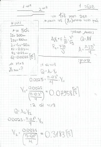

I just started hydraulics and this is the first problem I'm trying to solve. Please take that into consideration!
Given Two Pipes
Water is 50 degrees Celsius
http://img31.imageshack.us/img31/9752/74467684.jpg
I want to see if I understand this stuff correctly.
YL = The pressure lost through both pipes
L - Length of pipe
ID - Inner diameter
[ I'm not entirely sure what eA and eB mean - I think it says something about the quality of the surface? How smooth it is?]
So I got these three formulas
http://img11.imageshack.us/img11/963/yyyyyyj.jpg
I'm looking at my class notes and I got a few things missing.
Ra and Rb are "Reynolds" number for the pipes, yes? I imagine it's constant.
And the strange symbol at the bottom of Reynolds formula, that misshapen "V", that is a constant as well, yes?
I hope it turns out there are only these equations. It seems like a fairly simple problem.

Initially I would Calculate the velocity of the water on either side of the joint using Q=A*V.
That means I have to find the area first. So I have to use the formula for a cylinder's area to find area I need.
So area of a cylinder is: 2 x π x r2 + 2 x π x r x h
So the radius of pipe A = 100mm, the height is 200mm
The radius of pipe B = 50mm, the height is 100mm (the height is basically diameter, yes?)
So now plugging for the area I get
Area A = 188495.556 mm2
Area B = 47123.89 mm2
Is this all true so far?
The area in the equation Q=A*V is referring to the 'cross-sectional area' and so just the area of the circle.
This is pi*r^2 or pi*d^2/4 which is used more often at the uni I attend for circular cross-sectional area.
Also be careful to convert the diameters to metres.

So, cross-sectional area of a cylinder, that's just pi x r squared !
So, that'd equal for pipe A
Inner diameter = 0.2m
So, pi x 0.12 = 0.031416m2
For pipe B
Inner diameter = 0.1m
So, pi x 0.052 = 0.007854 m2
So both QA and QB = 0.0025 m3/s?
It doesn't seem to make since because Q is volume supply, and the wider diameter clearly has a bigger volume supply. But, I'm only given one of the Q and I'm not told to which pipe it belongs. Confusing!
There is no loss of water in the transfer of water from pipe 1 to pipe 2. So the volume flowing through one pipe must equal the volume flowing in the other pipe.
The larger pipe has a larger supply for a constant velocity, but the velocity is not constant the volumetric flow is.
If you consider the pipes separately. Assume that 0.0025m^3 per second is going into the left end of pipe A. That would mean that 0.0025m^3 is coming out the other end.
Q in = Q out
There are no holes in te system just the joint or change in pipe diameter.
The Q out of the pipe A must now become Q in of pipe B, but as it is narrower the velocity of the water will need to increase.
Does that help to see why the flow is constant in both pipes?

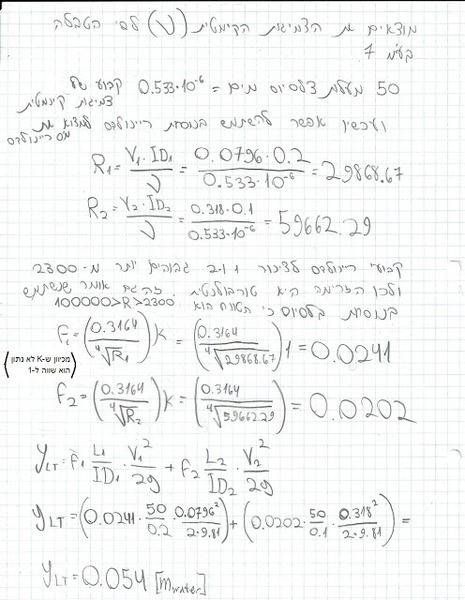

SOOOOOO to solve
For pipe 1
Q = VA
0.0025 = 0.031416V
V = 0.0025/0.031416
V = 0.0796 [m/s]
Hmm... are my units correct? meters per second?
For Pipe 2
0.0025 = 0.007854V
V = 0.318 [m/s]
So I now need Reynolds number so I could later find "f" (my friction coeffecient throughout the pipe)...but I still don't know the kinematic viscosity (which is represented by the greek letter "nu" as you said).
So I end up with two unknowns here (circled)
http://img827.imageshack.us/img827/4531/raraaa.jpg
So once again getting a bit stuck. A bit more help, please? :smile:

SOOOOOO to solve
For pipe 1
Q = VA
0.0025 = 0.031416V
V = 0.0025/0.031416
V = 0.0796 [m/s]
Your units are correct.
m^3/s = m/s * m^2 (if that makes sense)
Seems like an awfully slow speed, but i guess it is what it is.

The 'nu' value for kinematic viscosity for water can be found on a table if you know the velocity (this is where your 50degrees Celsius will come into play as the viscosity depends on temperature). There should be a table in your text somewhere or try 'Google-ing' kinematic viscosity of water.
Are you sure that I need to know velocity? Because I see a table graph with kinematic viscosity on the Y axis and Temperature on the X axis and then I see a line that describes how kinematic viscosity changes base on temperature. Such as (just without the numbers):
http://img847.imageshack.us/img847/5840/kinewaterok.jpg
So, shouldn't it be only temperature that matter?At 50 temp' it's our "mu" according to the table is 5.8 (it's hard to see the exact number, so it can turn up pretty inaccurate because it can be anywhere between 5.6 to 5.9). Can I use that?
Sorry you are correct I'm not sure why I wrote that bit on velocity. I wrote it from my phone so Iay not have proof read too well, sorry.
Yes the viscosity only depends on the temperature. Just check the magnitude though it may be *10^-6 or something like that.
http://img204.imageshack.us/img204/1996/temp11g.jpg
So its 0.553 x 10-6
Solving for Reynolds Numberhttp://img217.imageshack.us/img217/4820/reyrey.jpg Since Ra > 2300
This is turbulent flow. Now I can use the formula you gave me to find "f"
f= 64/Re
f = Darcy Friction Factor
So,
fA = 64/29868.67 = 0.00214And now Rb...
http://img43.imageshack.us/img43/9986/rbbb.jpg
f = 64/Rb
fB = 0.0011
So now I FINALLY can use this
http://img849.imageshack.us/img849/2505/solvedylt.jpg
WHEW! THat was a long one! Thank you so much lachy^^ :smile:
2 questions:
1) Is this all correct?
2) What are the units of YLT?
The Equation for te Darcy friction factor is a 'rough formula' u believe to be more accurate and incorporate your e values look up the Colebrook white equation, this might change your f value.
Ylt should be in m, I am a little unsure on the formula you used for this. Isn't there a v^2 meant to be in there somewhere?
You're right, I just read this:
In turbulent flow (R≥ 4000), the friction factor, f depends upon the Reynolds number (R) and on the relative roughness of the pipe, e/D, where, e is the average roughness height of the pipe
from here -> http://sites.google.com/site/excelsolveimpliciteq/
Which does make sense since they've provided me with values for eA and eB. And I do have turbulent flow if my values are correct.
But they're not actually giving me the formula. Where can I find it?
You're right, I forgot to square my V's :smile:
Thanks!
http://en.m.wikipedia.org/wiki/Darcy_friction_fzactor_formulae
Look at the equation section ( I realize it is wikipedia but it should stillbe correct). As the 'f' is on both sides of the equation you may need to do some iterations or look for a simplified solution.
Hmm.. your link doesn't exist
Alright, I figured it out, you just need to look at Moody's chart to get the answer :smile: when I have the full solution I'll post it. Thanks!
Actually I needed to use Balsius formula. At any rate, I'm just posting back to show you I got the full solution
Thank you very much, helped me tons! :smile:
