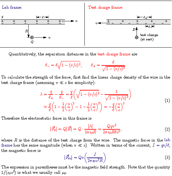

I know that magnetic force due to a current carrying wire on a test charge moving w.r.t the wire(along the wire), can be interpreted as the electrostatic force if we use the first order relativistic corrections for Time Dilation or Length contraction of the charges of the wire, in the frame of the the test charge.
But what I don't seem to understand is rather very simple situation.
Let's consider a simple model of a conducting wire,
Now, let's suppose there is some current in the wire and the electrons are moving at speed 'v' w.r.t the the wire,
secondly, a stationary test charge w.r.t the wire lying around.
Naming the above scenario as (1)
Now, the test charge starts moving in the direction of electrons with the same speed 'v'.
This time in the reference frame of the test charge, electrons are stationary and nucleus(positive charge) is moving at speed 'v'.
Naming this scenario as (2)
And so the question arise, the two scenario are identical w.r.t principle of relativity. That is, in the first case only negative charges are moving, but there is no force on the charge. But in the second case when positive charges are moving there is a force on the test charge(magnetic force towards wire). Whereas, the two cases are essentially identical w.r.t principle of relativity.

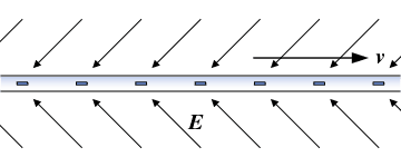

Thanks for the reply and the good link.
The explanation is quite good, but then we have another problem if we assume this explanation to be correct.
This is, why then we don't see any force when the situation changes from NO current to some current. Since, due to the motion of charges, which are responsible for current should also go through the length contraction when compared to the stationary state of these charges, when there is NO current.
Therefore, I think, according to the above explanation, there should be a magnetic force even if we switch ON or OFF the current.
If there is no current then the electrons are not moving therefore there is only one single reference frame and the test charge is stationary as are all of the charges in the wire. There is no length contraction, no net charge, and no force on the test charge with the current off.
Yes, that is correct.
But there should be all these effects when the current is ON, that is, when electrons are moving and therefore there should be length contraction and thus Force.

Yes, when the current is ON then the electrons and the test charge are moving, all these effects are present, and there is a force.
In the lab frame the force is attributed to the magnetic force on the moving charge due to the current in the neutral wire. In the electron/test-charge frame the force is attributed to the electrostatic force on the stationary charge due to the net charge in the wire.

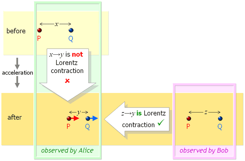

DrGreg said:
I think it is perhaps worth pointing out that some people have a false impression about what Lorentz contraction is. They may think that "when something accelerates it gets shorter". Or to be a bit more precise, if Alice measures (=x) something at rest (relative to Alice) and then later measures (=y) the same thing in motion, the length contracts. There may then be some debate over whether or not the "things" this applies to are just solid objects, or gaps between objects, or "space itself".
The above description of Lorentz contraction is wrong.
In many circumstances, what I said above is true, but reason it is true is not simply Lorentz contraction alone; it is Lorentz contraction plus some other reason combined.
A more accurate description of Lorentz contraction is that when inertial observer Bob measures the length z between two things both at rest relative to Bob, and another inertial observer Alice in relative motion measures the length y between the same two things at the same time, Alice measures a shorter distance than Bob.
So, the situation I described in the first paragraph will arise if there is a reason why Alice's initial "rest distance" x between the two things beforehand is the same as the Bob's final "rest distance" z. For example if the the two things are the two ends of a rigid object that doesn't break into pieces as a result of the acceleration.
The attached illustration emphasises my point. The transformation of x to y is not Lorentz contraction. The transformation of z to y is Lorentz contraction. If there is a reason why x = z, then the transformation of x to y will be a contraction. But if there's no reason, then contraction need not occur.
https://www.physicsforums.com/showpost.php?p=2443229&postcount=38
The application to this thread is that the electrons are not rigidly linked to each other so there's no reason for the rest-distance between them when moving to equal the rest-distance when not. In fact they will spread out to fill whatever space is available to them.
There is no "centre of contraction" because contraction-due-to-acceleration doesn't occur.

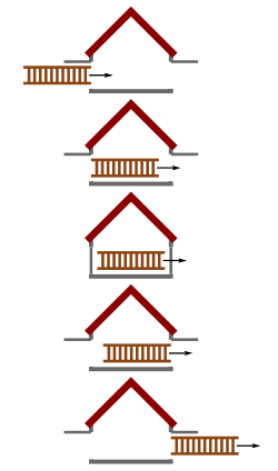

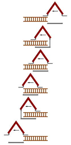

It seems to me that the Ladder paradox is relevant here:
http://en.wikipedia.org/wiki/Ladder_paradox
Ladder Paradox said:
Resolution
Figure 7: A ladder contracting under acceleration to fit into a length contracted garage
In the context of the paradox, when the ladder enters the garage and is contained within it, it must either continue out the back or come to a complete stop. When the ladder comes to a complete stop, it accelerates into the reference frame of the garage. From the reference frame of the garage, all parts of the ladder come to a complete stop simultaneously, and thus all parts must accelerate simultaneously.
From the reference frame of the ladder, it is the garage that is moving, and so in order to be stopped with respect to the garage, the ladder must accelerate into the reference frame of the garage. All parts of the ladder cannot accelerate simultaneously because of relative simultaneity. What happens is that each part of the ladder accelerates sequentially, front to back, until finally the back end of the ladder accelerates when it is within the garage, the result of which is that, from the reference frame of the ladder, the front parts undergo length contraction sequentially until the entire ladder fits into the garage.
This would explain the earlier comment by DaleSpam about "relativity of simultaneity".

http://en.wikipedia.org/wiki/Relativistic_electromagnetism#The_field_of_a_moving_point_charge
Relativistic electromagnetism#The field of a moving point charge said:
== The field of a moving point charge ==
|frame|'''Figure 3''': A point charge at rest, surrounded by an imaginary sphere.
|frame|'''Figure 4''': A view of the electric field of a point charge moving at constant velocity.
A very important application of the electric field transformation equations is to the field of a single point charge moving with constant velocity. In its rest frame, the electric field of a positive point charge has the same strength in all directions and points directly away from the charge. In some other reference frame the field will appear differently.
In applying the transformation equations to a nonuniform electric field, it is important to record not only of the value of the field, but also at what point in space it has this value.
In the rest frame of the particle, the point charge can be imagined to be surrounded by a spherical shell which is also at rest. In ''our'' reference frame, however, both the particle and its sphere are moving. Length contraction therefore states that the sphere is deformed into a spheroid, as shown in cross section (geometry)|cross section in Fig 4.
Consider the value of the electric field at any point on the surface of the sphere. Let x and y be the components of the displacement (vector)|displacement (in the rest frame of the charge), from the charge to a point on the sphere, measured parallel (geometry)|parallel and perpendicular to the direction of motion as shown in the figure. Because the field in the rest frame of the charge points directly away from the charge, its components are in the same ratio as the components of the displacement:
:[itex]{E_y \over E_x} = {y \over x}[/itex]
In our reference frame, where the charge is moving, the displacement x' in the direction of motion is length-contracted:
:[itex]x' = x\sqrt{1 - v^2/c^2} [/itex]
The electric field at any point on the sphere points directly away from the charge. (b) In a reference frame where the charge and the sphere are moving to the right, the sphere is length-contracted but the vertical component of the field is stronger. These two effects combine to make the field again point directly away from the current location of the charge. (While the y component of the displacement is the same in both frames).
However, according to the above results, the y component of the field is enhanced by a similar factor:
:[itex]E'_y = {E_y\over\sqrt{1 - v^2/c^2}} [/itex]
whilst the x component of the field is the same in both frames. The ratio of the field components is therefore
:[itex]{E'_y \over E'_x} = {E_y \over E_x\sqrt{1 - v^2/c^2}} [/itex]
So, the field in the primed frame points directly away from the charge, just as in the unprimed frame.
A view of the electric field of a point charge moving at constant velocity is shown in figure 4. The faster the charge is moving, the more noticeable the enhancement of the perpendicular component of the field becomes. If the speed of the charge is much less than the speed of light, this enhancement is often negligible. But under certain circumstances, it is crucially important even at low velocities.
In any case, it would seem that length contraction of the electrons only (rather than the whole bulk of it) would increase the E-field contribution normal to the wire by a certain amount. This amount is [itex]\gamma[/itex]. If, on the contrary, it were actually like I said, with an increase in charge density on top of that due the current, then this amount would be [itex]\gamma^2[/itex].
But is there another affect on the E-field, due to time dilation?
The following graphic suggests to me there is also an effect due to relativistic aberration:
Is there any good summary of these effects?
