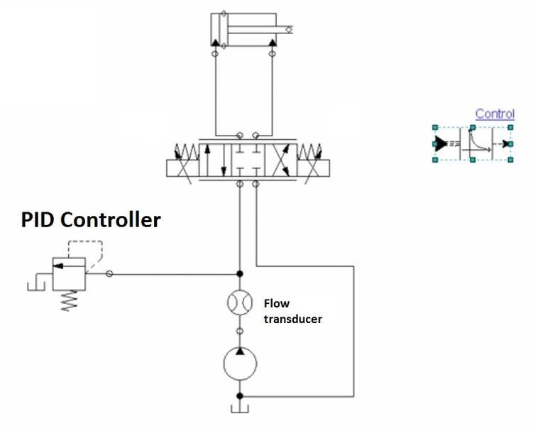

Integral, thanks a lot for your answer. In the meantime I found this, which is about a hydraulic system. Except for the fact that practically water can't be compressed, the circuit has the same function as the pneumatic one. I believe the PID controls the flow through the transducer. Is that possible? And how does it do it?

I have encounterd hydrolic pistons which used DI water for the driving fluid.
You can get digital flow control, but it won't be cheap. Not sure why you would want to. Just put normal flow controls on the cylinder and you should be good.

A PID is a linear control element, meaning it's continuous not discrete. It usually employs a "transducer" to control flow or pressure.
A transducer might be an electromagnet that's in a tug-of-war against a bellows with pressure inside, so that current through the electromagnet controls pressure in the bellows. Search on "force balance transducers" and see what tutorials you can find from control companies like Rosemount, Fisher, Conoflow, Foxboro etc.
