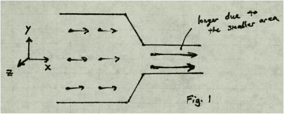

Say we know that in an irregularly shaped volume conductor (e.g. a nerve fiber, where the irregularity is due to some sort of biological obstruction), the current density [itex] \vec{J} [/itex] has the form given in Figure 1 (see attachments).
The current [itex] I [/itex] is --- I think --- given from Ohm's law: specifically, if the potential difference across the ends of the fiber and the total resistance of the fiber are known, then

Now I know that the surface integral of a flux gives a flow rate, so the surface integral of [itex] \vec{J} [/itex] should give a current. But is the current equal to [itex] I [/itex]? I mean, does
[tex]
\begin{equation*}
\iint_S \vec{J} \cdot \vec{n} dS = I
\end{equation*}
[/tex]

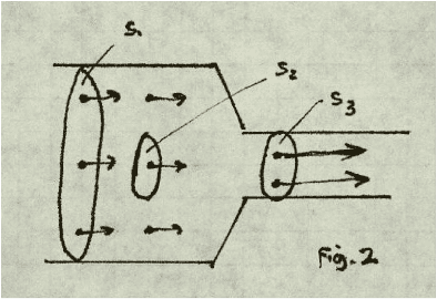

for every [itex] S [/itex], or only for [itex] S [/itex] = cross-sectional area of the conductor? The reason I ask is because, if I draw three example surfaces [itex] S_1, S_2, S_3 [/itex] (Figure 2), the surface integral of [itex] \vec{J} [/itex] over [itex] S_1 [/itex] is obviously not equal to that over [itex] S_2 [/itex].
So I guess what I am asking is: is
[tex]
\begin{equation*}
I = \iint_{S_1} \vec{J} \cdot \vec{n} dS_1 = \iint_{S_3} \vec{J} \cdot \vec{n} dS_3 \neq \iint_{S_2} \vec{J} \cdot \vec{n} dS_2
\end{equation*}
[/tex]
true, where [itex] I [/itex] is current as found from Ohm's law? And if so, does this mean that any current [itex] I [/itex] through a conductor is not simply the rate of flow of charge, but a rate of flow of charge implicitly with respect to the cross-sectional area?

No, this is wrong. Current I is a total amount, that is, it's the integral of J across a surface as you've written below. It doesn't make sense to talk about I at an infinitesimal point (x,y,z).
In your example, it is the second option.
Yes.

Yes. Usually it's obvious what that surface is (current in a wire refers to the area of the wire), but if the surface isn't obvious then you need to specify it.
