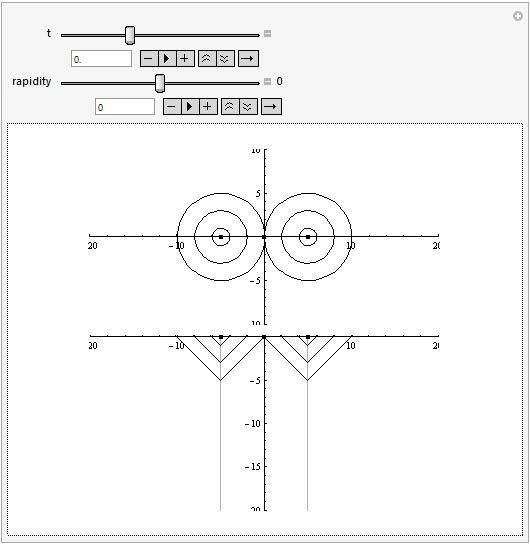

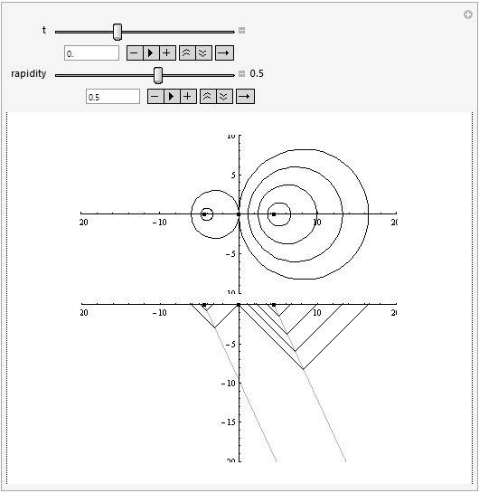

I think I've seen somewhere, where they just take the space-time graph and rotateit it 45 degrees, and then the transformation becomes a contraction/expansion on the horizontal axis, and vice-vers on the vertical axis.
I think this constant sized region here involves four distinct events. Two photons leave a spot, hit something to turn around, and meet again. That would enclose a region of space-time that would have constant area under lorentz transformation.
But in general, no. If you have a photon going from one place to another, the best description of locality for it is zero. Effectively, there is a direct interaction between the particles at the origin, and the particles at the destination, with one caveat: The destination event definitely happens after the source event.
This is totally off-topic from the idea of local lorentz, but there is another interaction that I find interesting and related; when the photon is produced in, say, a Helium atom, this occurs when the electron falls into a lower shell, or perhaps when it hits the lower shell. Does the photon arise from the interaction of two particles, or does it arise from the acceleration of one particle? Is there a direct interaction between the proton and electron (one event?) or are they separated by a finite distance when they interact (two events?), or is the photon generated in a process that takes place in a region of time and space?
So (1) at the source, there are two events which occur at the same time, and (2) in between, there are events which definitely occur one after the other, and (3) at the destination, there are two events which occur at the same time.

The attached diagrams helped me to see my mistake. There are two emitters in the diagram, and one receiver between them. In the first diagram the two emitters are stationary and the number of waves is the same. In the second diagram the two emitters are traveling to the left. Because of the relativity of simultaneity, the emitter on the right began broadcasting long before the emitter on the left. This allows there to be a larger number of wavelengths present in the approaching emitter than there are in the receding emitter.
Edit: With the receding emitter and the chasing receiver, eventually the wavelength of the photon is going to be longer than the lorentz contracted distance between the emitter and receiver. This is another reason that I say "the photon is a direct interaction between the emitter and receiver."
This is a different situation from the one I was discussing. You have two emitters and one receiver, instead of two receivers and one emitter; and in the "moving" frame you have the emitters moving but the receiver still at rest (if I'm reading your diagram right), whereas I was discussing the case where emitter and receivers are all mutually at rest (but where the "observer" that's watching all three might be moving relative to them). Obviously if you change the relative motion of emitter and receiver, you'll change the physics.
Try it with one emitter, at x = 0, and two receivers, one at x = R and one at x = 2R (i.e., both lying in the same direction from the emitter, but one twice as far away as the other), in the frame in which they are all mutually at rest. Then transform to a frame in which all three are moving with the same velocity v. That's the case I was talking about.
