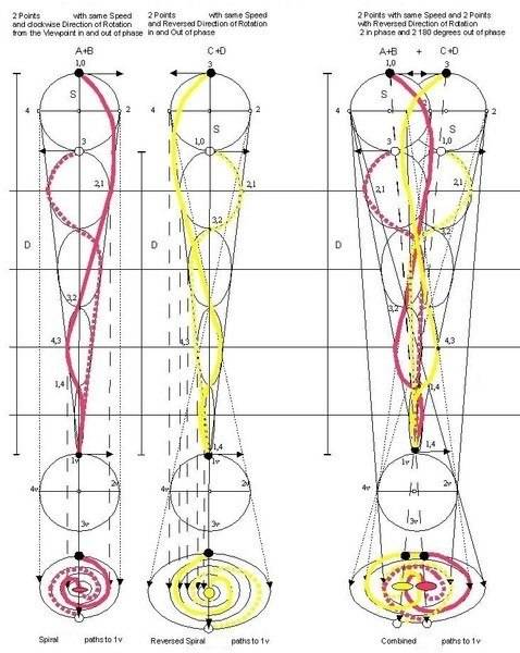

Post 19 in the philosophy thread, Overnight everything has doubled in size, shows how a dimensionless constant can be used to forge a consistent observation scale for the comparison of different measurement data sets of the light emitted from rotating sources being observed on galactic year scales in a Euclidian 3D+t space.
The attached image shows the Light paths expected traveling from source(s), rotating around a stationary galactic centre, to a stationary observation point in a Euclidian 3D+t space during one complete rotation. These curved but straight light paths are to be expected at the observation time when physically observing rotating sources continue to rotate and emit while the light being observed travels all the way to the observer at a consistent speed. If we apply an imaginary translation we will get Euclids original internal perspective (imaginary) of a beam of light traveling in a straight line to the stars, when he opened his eyes at night. This internal field theory conception should not be considered as Euclidian space which provides an external perspective (reality).
The closest I can get to modelling an external perspective (reality) in measureable internal perspective (imaginary) reality is in the images attached to the Fun Photos & games thread, Feedback loop photos. The only variables in the loop setup required to create the last image posted is only three different angles of rotation, one distance and a carefully placed mirror. If we remove the mirror we can get a stable perfect orb state, which is obviously constructed of the cuumulative lag within the measuring system, as you can see in the screen captures (the outside spinning and being drawn into the center, i.e the reality to imaginary flip).
A measureable internal perspective (imaginary) reality is not equivalent to an external measureable perspective (reality) and that is the real difference.
