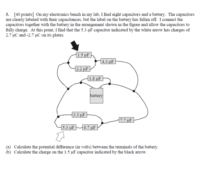

VCalculate the potential difference (in volts) between the terminals of the battery

I reduced to equivalence capacitance and found the potential difference between the nodes based on what was provided using the rules of parallel and series and my final answer doesn't match the answer given. I have a test in two days and have been studying this along with other subjects. Could someone please lay out the answer methodically for me?
This was from a practice test he gave us to do,which he gave last year. I've done the other question but am stuck on this one.

It seems to me the potential across the 5.3 μC cap is V = Q/C = .5094.
Did you get that as a first step?
If the capacitors were initially uncharged, I think there is something about the 5.3 and 6.7 μC caps in series that must be the same, and allows you to calculate the voltage on it, too.

What I did was first made an equivalence capacitor between the 5.3 and 6.7 C's they are in series so Ceq =(1/5.3 +16.7)^-1 =2.959. In that the charge for the 5.3 Cap was 2.7, then the 6.7 has to have the same, and the total charge for the Ceq capacitance would be 2.7. then I reduced the 3.3 and 2.959 capacitance, now in parallel to and new equivalent Ceq = 6.2516. The sum charge would be Qtotal = 2.7 +q(on 3.3 cap) = Ceq*V where Ceq = 6.2516 with some algebra I found the charge for q(on 3.3 cap) to be 4.133 and the V to be 1.0931...i think something's fuzzy with what I did though. Does everything I've done so far seem correct? I basically continued the same process until it was down to an super (lol) eqv Capacitance (5.44 175) and the 1.8 in parallel...Does anything I've done so far make sense? lol
Looks like you're thinking about it ok, but your result 4.133 for the charge on the 3.3 cap and 1.0931 for the voltage V are not correct.
It might be a good idea to work out the voltages on each capacitor as you go along.
So, what do you get for V for the 5.3 and 6.7 capacitors individually?
Agree with that, and then you can get the V = Q/C = .4030 for the 6.7. The 5.3 and the 6.7 are in series so the voltage across the two of them is .4030 + .5094 = .9124
That same potential is across the 3.3 so you can work out its Q=CV = 3.011.
This puts us in disagreement! I don't understand how you got 4.133 for the 3.3's charge and 1.0931 for the Voltage.
I finished the problem and got 1.65 V without using any series or parallel capacitance formulas.

Yeah, that's what I did but I'm very sloppy with my notes. I'ma work this whole problem out again neatly when I'm done with these mechanics questions.
Do you see how to get the voltage across the 3.3 capacitor from the voltages for the 5.3 and the 6.7 capacitors?

It's easier to get the voltage across the 3.3 cap by just adding the voltages across the 5.3 and 6.7 capacitors. No need to find the equivalent capacitance to get the voltage across the 3.3 capacitor (as Delphi51 noted).

Yeah just did the same thing and got 1.65202 myself. :) just needed to keep my numbers in order!

It was not productive to combine the capacitors because it obscured the ability to deduce the charges and voltages around the circuit.
