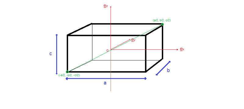

Consider a cuboid of lengths a, b and c along the x, y and z axes respectively, centred at the origin.
The task is to show that the moment of inertia of the cuboid of mass M and mass density ρ about an axis along the body diagonal, from (-a/2, -b/2, -c/2) to (a/2, b/2, c/2), assumes the form:
##I = \frac{M}{6}\frac{(ab)^2+(ac)^2+(bc)^2}{a^2+b^2+c^2}##
This is supposed to be done by making use of previously determined results. These are, that the moments of inertia assume the form:
##Θ_{xx}=\frac{M}{12}(b^2+c^2)##
##Θ_{yy}=\frac{M}{12}(a^2+c^2)##
##Θ_{zz}=\frac{M}{12}(a^2+b^2)##
and also, that all the products of inertia vanish.

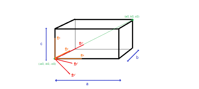

I have been thinking about the rotation of the coordinate axes. Is the following picture accurate?
In this representation, the ##e_z## axis is rotated towards the body diagonal by an angle which will be equal to ##tan^{-1}\frac{\sqrt{a^2+b^2}}{c}##.
Two things come to mind when considering the transformation. Under O(3) passive rotations, the moment of inertia tensor transforms as follows:
##O(3): I → I'=OIO^T##
Secondly, perhaps the determinant of the Jacobian matrix for the coordinate transformation would need to be considered.
Are either of these approaches the correct way to proceed?

The key equation is Equation 4.8 in the last article you linked. The symmetry of this particular problem can be exploited, in that we do not need to consider "direction cosines" because the axis along the body diagonal is in the direction of the unit vector: ##\frac{a}{\sqrt{a^2+b^2+c^2}}\hat{i} + \frac{b}{\sqrt{a^2+b^2+c^2}}\hat{j} + \frac{c}{\sqrt{a^2+b^2+c^2}}\hat{k}##
where a, b, and c are simply the lengths of the cuboid in the x,y and z directions respectively.
Now examining Equation 4.8, the last three terms can be ignored if the products of inertia, about the body diagonal axis, are zero. How does one know if they are zero? Bearing in mind that the body diagonal is neither a principal axis or an axis of symmetry.
Nevertheless if the products of inertia are taken to zero, then Equation 4.8 can then be written as:
##I_Δ=I_{xx}\frac{a^2}{a^2+b^2+c^2} + I_{yy}\frac{b^2}{a^2+b^2+c^2} + I_{zz}\frac{c^2}{a^2+b^2+c^2}##
Hence:
##I_Δ=\frac{M}{12}(b^2+c^2)\frac{a^2}{a^2+b^2+c^2} + \frac{M}{12}(a^2+c^2)\frac{b^2}{a^2+b^2+c^2} + \frac{M}{12}(a^2+b^2)\frac{c^2}{a^2+b^2+c^2}##
And through simple algebraic rearrangements:
##I_Δ=\frac{M}{6}\frac{(ab)^2+(ac)^2+(bc)^2}{a^2+b^2+c^2}##
as required.
