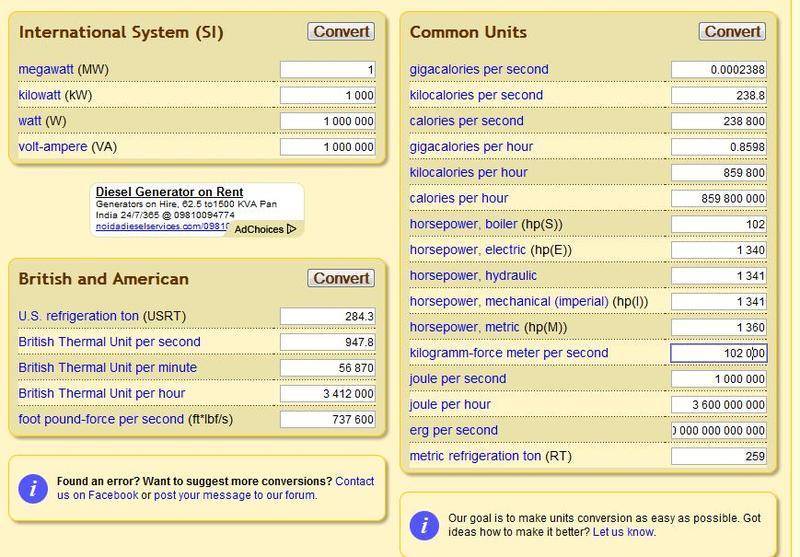

Nov26-12, 04:09 AM   #9
In my book "Kg-m/Sec" is a ambiguous unit because force isn't measured in kg but Newtons. So can you tell us how you arrived at 1,02,000 Kg-m/Sec ?
This is the URL that I referred. You can also check that:
http://www.convert-me.com/en/convert/power/
Simply to say, How much energy (in Kg-m) I need to run 1 MW generator for 1 hour. I have to store available mechanical energy (Linear) and used that energy to run the Generator.
thanks
pmk69
