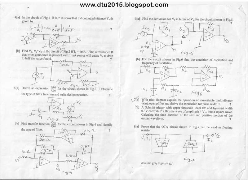

OP-Amp connected with Transistor whose Base and Collector are short
In summary, the problem involves analyzing a circuit with two transistors and an operational amplifier. The goal is to find the output voltage, Vo, as a function of the input voltage, Vi. The first transistor must be forward biased with a voltage drop of 0.7 volts, and the second transistor's voltage drop depends on Vi. If the second transistor is forward biased, the circuit is open and Vo2 becomes 0 volts. The final answer is that Vo = 0 when Vi < 0 and Vo = 12 when Vi > 0.
darkxponent
387
Problem number 6a in the picture.
Transistor:
Ic = βIb
Ic = αIe
Ic = Is*e^(Vbe/nVt)
OP-Amp:
Vo = Acl*Vi
Acl = 1 + (Rf/Ri)
I tried to solve but just couldn't understand the behavior the transistor.
First, find Vo1.
Then find Vo.
Note that Q1 and Q2 behave like p-n junction diodes.
I tried that.
Now Q1 must be forward biased so that the constant current Iref flows through Q1 and the voltage drop across Q1 is 0.7 Volts that is
Vbe1 =.7 Volts
Vo1 = Vi*(R4/R4+R3) - .7
Now what will be the behavior of transistor Q2? The Voltage across it depends on Vi
Vbe2 = .7 - Vi*(R4/R4+R3)
So how can i take diode 2 as forward or reverse biased without knowing Vi?
If the diode 2 is forward biased then where does the current go at NODE Vo1. Does it go into the OP-Amp1?
Taking the Diode 2 reverse biased the circuit is open and Vo2 becomes 0 Volts
PS: I don't have a camera right now or i could have shown you the full attempt.

You can't!
What current? Vo1 sinks currents from both diodes. Obviously, all net diode current has to go into op amp 1's output.
Q1 current is always = I_ref.
That is correct.
Hint: You got Vo1 right.
This circuit is a Rube Goldberg comparator. The output Vo tells you whether the input is above or below a certain threshold voltage. What is the correspondence between input voltage and output voltage? Vo is one voltage when Vin is < threshold and another when Vin > threshold.

Thanks for help. Now tell me is this the answer
1) When Vi < .7*(R4 + R3)/R4, Vo = 0 Volts
2) When Vi > .7*(R4 + R3)/R4, Vo = R3*Is*e^((.7 - Vi*(R4/R4+R3))/nVt)
'Fraid not.
First, what is Vo1 as a function of Vi?
Second question, what happens if Vo1 is < -0.7V or > -0.7V?
BTW your expression for Vo must be compared to the saturation output voltage. Your op amp can't go more positive than a certain voltage, say +12V for a 741 op amp running on +/- 15V supplies. This applies to terms like your Vo = R3*Is*e^((.7 - Vi*(R4/R4+R3))/nVt) which might be correct if your op amp had no saturation limit.
1) Vo1> -.7 that is Vi > 0, Vo = 0 Volts
2) Vo1 < -.7, Vi < 0
In this case the diode would be forward biased and second op-amp would behave as a negative comparator and then op amp will saturate at positive saturation voltage that is 12 volts.
Is this the right answer?
Absolutely correct. Good work!
