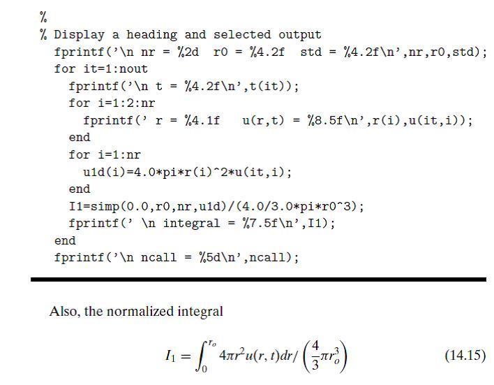

Got stuck with function integration using Simpson's rule and need your help.
Please first refer to picture attached for full idea of my question:
The Matlab command related to it is:
for i=1:nr
u1d(i)=4.0*pi*r(i)^2*u(it,i)
end
I1=simp(0.0,r0,nr,u1d)/(4.0/3.0*pi*r0^3)
I1 is
nr=21
r0=1.0;
Does it mean that I1 is integrated 21 times between boundaries 0 and r0?

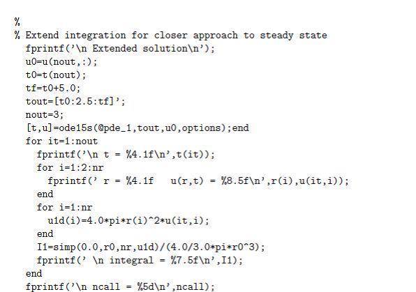

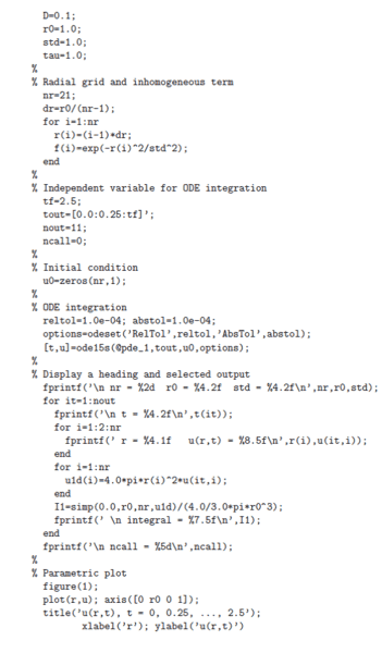

Feb27-13, 08:27 AM   #3
Yes. Sure
I have attached all commands with order from Pic.1 to Pic.3
