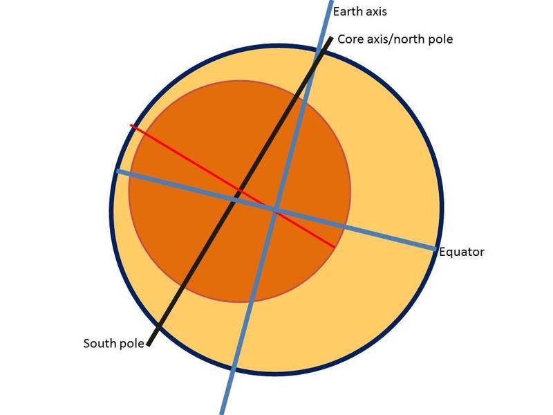

Could any of these forces apply to the Earth's core?
Do you know an effect not explain on Earth and forces can explain ?
