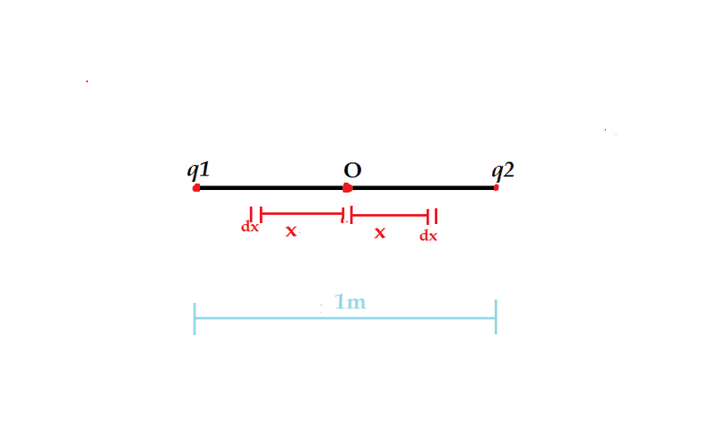

Two point charges q1=1[itex]\mu[/itex]C and q2=-1[itex]\mu[/itex]C with mass 1g each are at distance 1m from each other. The charges are released from rest at . Find the time t in seconds at which they collide.
F=kQ1*Q2/r^2.
Let the dist. of separation be r and the mass of charged be m.
I think they will meet at the middle of separation.Force on q1=kq^2/r^2 so the acceleration =kq^2/r^2*m.But in this case acceleration is not constant.So I have to use calculus here.
Let the charge q1 be at origin and at a distance x from origin acceleration=kq^2/(r-2x)^2*m( 'r-2x' because if q1 will move x meter towards q2 then q2 will also move x metre towards q1 so the length of separation will decrease by 2x) .
For a small displacement dx this acceleration is constant.I tried to use S=ut+at^2/2.But I am unable to find u.Please help.

The other should also be x m distance from the center.So the distance between them should be 2x.
I should have choose origin at the center.Now at a distance x from the origin acceleration of q1 will be kq^2/(4x^2*m).Here m is for mass of particle.
I have made this figure
I have made this figure View attachment 71218.

kq[itex]^{2}[/itex]/4x[itex]^{2}[/itex]=m*d^2x/dt^2
I think x decreases with time because as the time passes both the particle move toward origin so their distance of separation decreases.
Look at m1. The force acts to the right. The acceleration is to the right. Does x increase?
ehild
According to figure which I have made in post#4 it seems that x decreases and acceleration increases because x is measured from origin and in this figure origin is at the middle of the line of separation.
Yes. So -kq2/4x2=m*d^2x/dt^2

Initially E(potential)=-[itex]\frac{kq^{2}}{r}[/itex] (I got -ve sign as the charge at the left is negative)
Now at x kinetic energy of system = kinetic energy of the CM+ kinetic energy of all particles relative to the CM.
E[itex]_{k}[/itex] at x=mv[itex]^{2}[/itex]
E[itex]_{p}[/itex] at x = -[itex]\frac{kq^{2}}{2x}[/itex]
so
-[itex]\frac{kq^{2}}{r}[/itex]=mv[itex]^{2}[/itex]+ -[itex]\frac{kq^{2}}{2x}[/itex].
v=sq.root of [itex]\frac{kq^{2}(r-2x)}{2mxr}[/itex].
the figure is here View attachment 71218.V is the velocities of particles at x.
Now write v =dx/dt and integrate to find x as function of time .
