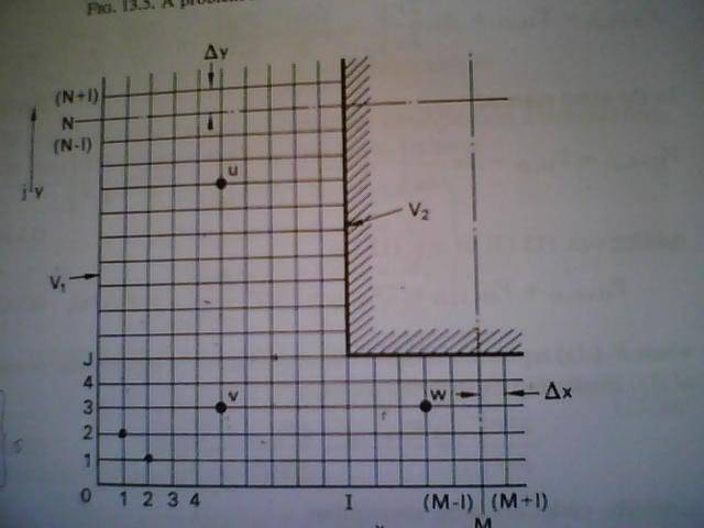

Hi,
I'm here for help and hope somebody could give a hand on this because I'm noob in this.
I'm now constructing a MATLAB program to find Electrical field and potential within a square grid mesh with square cavity inside.
like the picture above.
I only manage up to this

It seems that I'm now stuck where should i put a restriction to where the cavity is(that means, the program should not be calculating the V at that nodes)
can you give me some ideas how should i proceed with this?
thanks in advance.
regards
