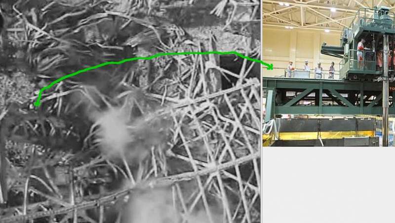

TCups said:
http://i306.photobucket.com/albums/nn270/tcups/Picture45.png
Unfortunately you got it wrong... and miss read the picture.. your over head crane need to be slided slightly to th right (north)
I'm 80% confident that we are seeing a round heat emitter bellow the crane, the round shape is the one of the Concrete stab or to be exact the lack of...

CORRECTED THERMAL IMAGE BLDG 3 -- OVERHEAD CRANE'S POSITION CHANGED
Per Fred's observations:
|Fred said:
Unfortunately you (TCups) got it wrong... and miss read the picture.. your over head crane need to be slided slightly to th right (north)
If the plug is gone, then it is indeed unfortunate. I stand corrected on the position of the crane, Fred. And I can see heat leaks around the edges, yes, but do you really think the entire concrete plug is gone? Where? For that to be the case, wouldn't the greatest visible damage to Bldg 3 have to be in the center of the building? Or did the plug hit the underside of the crane and fragment? Or did the plug blast free and then an intact section of roof girders and the crane fall back into place over the open mouth of the reactor's primary containment?
http://i306.photobucket.com/albums/nn270/tcups/Picture47.png

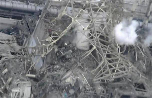

I thought that concrete plug was a missile protection, so it would be incredibly strong and would have remained in one (or 8) pieces after a blow out.
  • #2,752
The strong evidence says reactor 3's primary containment was breeched at the time of the blast (as was Unit 2's). Fred and I agree on that I am pretty certain. I can understand a blast from the primary containment loosening the plug -- maybe even leaving it completely askew, or fragmenting its sections, if it is in multiple sections. But I still believe it was the FHM that went ballistic, and that most of the blast diverted through the transfer chute. I am not sure it makes a lot of difference either way at this point. The biggest problem is and will continue to be the hottest thing in the thermal images of B3 and B4 -- the spent fuel pools, which were never "contained" from the beginning, and this has been my greatest worry from the onset of the first explosion. What a mess . . .
Why the lack of? Given the low IR temps recorded wouldn't it make sense for the round plug to be in place but slightly warm from the very hot (melting?) fuel rods inside?
