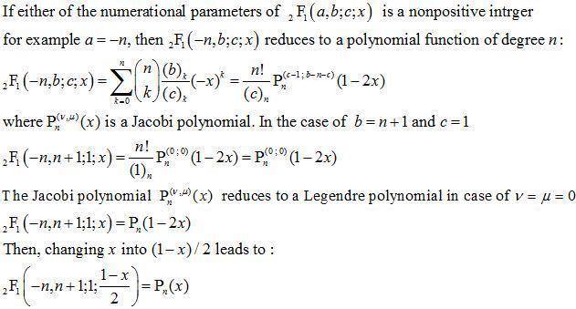

| Jan8-13, 01:43 PM | #9 |
I don't understand why. J. Jacquelin I didn't get the answer from reading your text. How you get connection between Legendre polynomial and #_2F_1#? |
| Jan8-13, 04:07 PM | #10 |
#_2F_1(a,b;c;x)# converge for #|x|<1#. Ok so I know that from this hypergeometric function I could define Legendre polynomials because they are defined for #|x|<1#. From Safari file
[tex]P_n(x)=_2F_1(-n,n+1;1;\frac{1-x}{2})[/tex] From this table I see that [tex]T_n(x)=_2F_1(-n,n;\frac{1}{2};\frac{1-x}{2})[/tex] Laquerre polynomials are defined on the interval #[0,\infty)# so [tex]L_n(x)=_1F_1(-1;n;x)[/tex] What that means? That degenerate hypergeometric function converge in the interval #[0,\infty)#? Hermitte polynomials are defined in the interval #(-\infty,\infty)#. [tex]H_n(x)=(2x)^n_2F_0(\frac{1-n}{2},-\frac{n}{2};\_;-\frac{1}{x^2})[/tex] Is there some easy way to see in what interval [tex]_p F_q[/tex] converge? |
