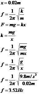

1) An object is hung from a light vertical helical spring that subsequently stretches 2.0 cm. The body is then displaced and set in SHM. Compute the frequency at which it oscillates.

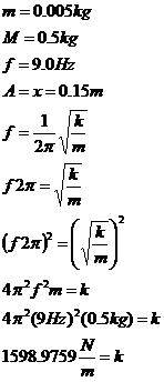

For the second problem, shouldn't you be using the combined mass (block + bullet) in your calculation of k? After all, *that* is what is oscillating at 9.0 Hz (the combined object).
In contrast, for your calculation of the initial speed, all of the kinetic energy that is converted into elastic potential energy is from the bullet. So why are you using the combined mass here?
1) The formula that you use is for a simple pendulum. Here you have a spring-mass system.

As for number one, here is all my work that I didn't include the first time to help you see I'm not trying to use the pendulum equation.
This seems to be correct.

Your work for number 1 is still incorrect. If you read through this thread, it might help illuminate some of your misunderstandings: https://www.physicsforums.com/showthread.php?t=321959
In a vertical spring-mass system at rest at equilibrium, the upward spring force is
Fs = k xeq where xeq is the amount by which the spring is stretched from its unstretched position.
There is a downward force mg. Because the system is at rest, the two forces have equal magnitudes. Therefore,
mg = k xeq from which we get k = mg/xeq. If we substitute this in the equation for the frequency of the system, we get
[tex]f = \frac{1}{2\pi} \sqrt{g/x_{eq}}.[/tex]
Oops . . . :blushing: I guess I should probably read more thoroughly next time. Thanks for cathcing that.
For Problem #1
Hooray! Thanks kuruman for checking. I have 18 problems to work on and now I feel confident about at least 1!

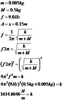

Thanks for the tip cepheid. Here is my new k.

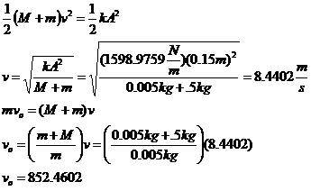

I’m saying that v is the initial velocity of the bullet while V is the initial velocity of the block.
If my second equation is correct I should be able to solve for the initial velocity of the bullet, for v. However, I got that the initial velocity of the bullet was 0.1031 m/s. I know that is incorrect. How can I find the correct equation? Is my initial velocity for the block at least correct?
I'm STILL on this problem. I didn't think I'd get stuck on the simple harmonic stuff. I have much more difficult problems to try after I get this one.
I know I'll need the conservation of momentum: mv=(m+M)v' where v' is after the impact. I think this because the block and bullet become one object. Am I thinking incorrectly?
I tried making the assumption that v' is the answer I got in the last equation.
However I'm told that the block's initial velocity is at rest so is V really 0? I want to believe the answer I obtained the my last post is useful somehow, so I don't want to believe V is 0. I want to believe v' = V so I can have this. Is it right?
This sentence leads me to believe that my logic is for the picture in the post is incorrect. However, I do not know why I cannot use the combined mass if my v'=V? I am missing the correct logic.
What I said was misleading, because energy is not conserved. You can figure out the initial velocity of the block + bullet (i.e. right after the collision) by looking at how much energy would have been required to depress the spring by that amount. However, this does not tell you the initial velocity of the bullet (before the collision). For that you will need to apply another conservation principle.

My 10th post shows I know I need to apply the conservation of momentum formula and I tried to do so in that post. Since no comment was made on the work I showed, I have to consider that everything I did may not be right.
Looking at Kuruman's 3rd post, I think that maybe I should say that the intitial velocity of the block is 0. Is that true? (Y/N/Maybe or you're not going to tell me?? it must be a trade secret)If that's true, then according to the formula I have available that no one has told me is incorrect.
mv=MV+mv'
mv=mv'
mv'
-- = v
m
However I know this is wrong because the answer is too small. This leads me to finally conclude that the last two posts I made aren't right.

Your linear momentum conservation equation is incorrect because it has too many vees. After the bullet stops within the block, both bullet and block have the same speed v'. So the equation should be
mv = (m + M) v'
This v' is the initial speed of the (block + bullet) system when it starts oscillating as a spring-mass sytem.
I am sure this will fix quite a few issues.

Energy is not conserved here, because this is an inelastic collision (the bullet becomes embedded in the block, and so some of its energy goes into deforming / heating / boring through the block).
Here is what you have to do step by step:
1. Determine how much elastic potential energy is initially stored in the spring when it is compressed (which you have done).
2. Equate this elastic potential energy to the initial kinetic energy of the *combined block + bullet mass* just after the collision.
3. Use this result to determine the speed of the combined block + bullet mass just after the collision.
4. Use this speed, and the law of conservation of momentum to determine the initial speed of the bullet (before it struck the block).
When you say that the energy of the bullet before it hits the block is the same as the total energy of the harmonic oscillator after the bullet is embedded, namely
[tex]E = \frac{1}{2} kA^{2}[/tex]
you are asserting that mechanical energy is conserved throughout the process. This is not true. While the bullet decelerates inside the block, some of its mechanical energy is converted into heat by the friction that stops it. However, once the bullet stops moving, mechanical energy is conserved from that point on because there is no more friction to dissipate mechanical energy as heat. After the bullet stops inside the block, the bullet+block system must move to conserve momentum.
The equation to use is
[tex]\frac{1}{2}(m + M)(v')^{2}=\frac{1}{2} kA^{2}[/tex]
This says that the kinetic energy of the bullet+block system when the spring is initially unstretched right after the bullet has already stopped is the same as the potential energy stored in the spring at full compression. Because v' appears in this equation, you have to find it.

E = 18.1672
E = 0.5(M+m)v'2
v' = [tex]\sqrt{\frac{2E}{M+m}}[/tex]
v' = [tex]\sqrt{\frac{2*18.1672}{0.505}}[/tex]
v' = 8.4822 m/s
v = [tex]\frac{(m+M)*v'}{m}[/tex]
v = [tex]\frac{0.505*8.4822}{0.005}[/tex]
initial velocity of the bullet = 856.7022 m/s
