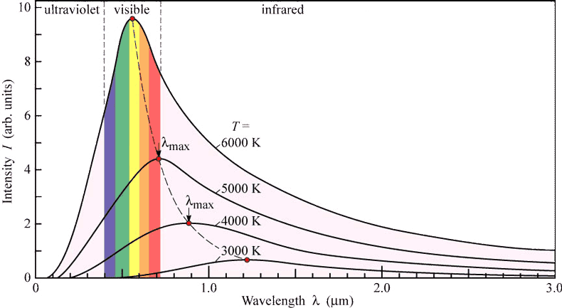

When you have a black body radiating (as a star) you get an idealized light curve (image below) that depends almost entirely on its temperature. The chemical composition plays some part, but it is mostly on the temperature.
When the photon passes through the atmosphere of the sun some light gets scattered by the atmosphere. This causes the continuous spectra of the sun to have dips in its emission lines. These dips are what tells us the chemical composition of the sun, or at least its atmosphere, which we think is representative of the entire star.
I just googled for black body radiation curve and this came up.
White light is the mixture of colours from the whole visible spectra. When the peak in brightness of a black body is smack in the middle of the visible spectrum it comes off as white light.
If the star has higher temperature, the photons escaping will have a higher energy, which translates into shorter wavelength, which result in the star looking more blue.
So the curve of the black body radiation curve depends only on its temperature. Our sun is of the right temperature to radiate white light.
