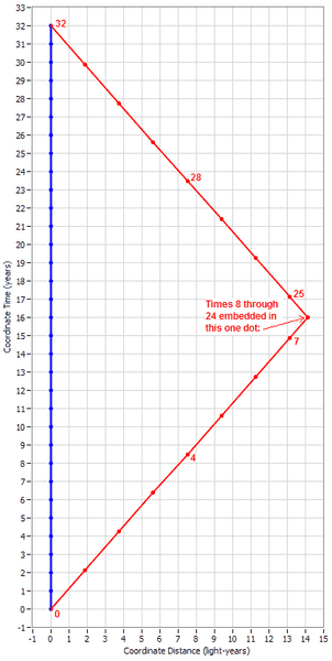

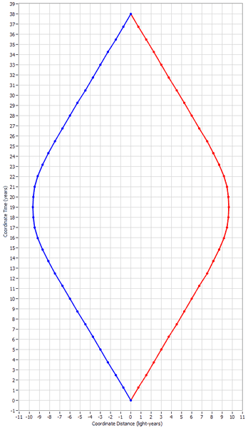

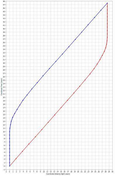

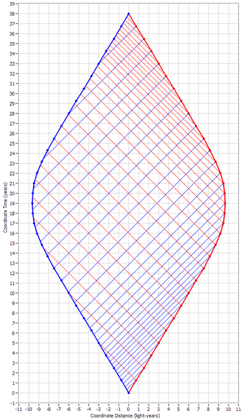

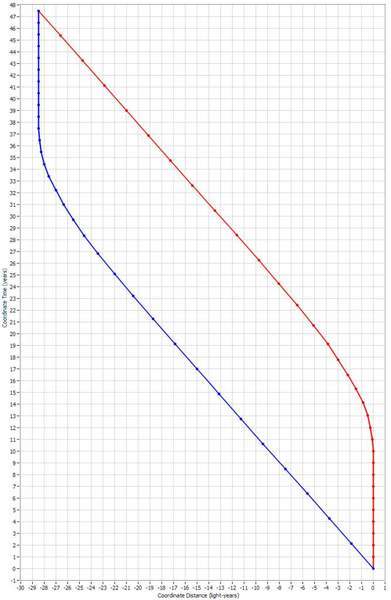

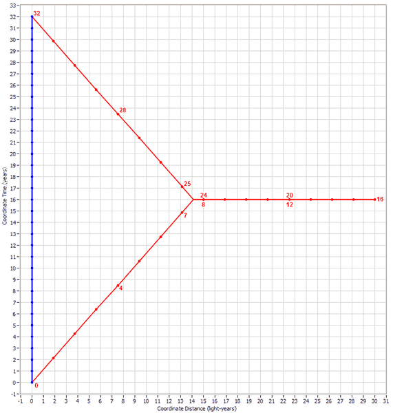

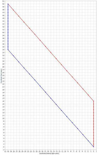

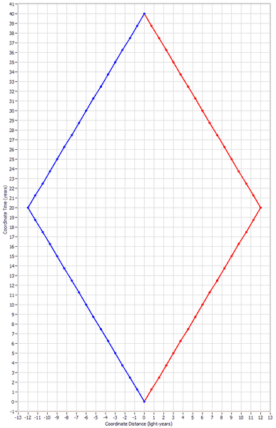

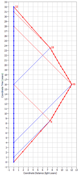

You have described a symmetrical scenario which requires symmetry in your initial Inertial Reference Frame (IRF). Here is a spacetime diagram depicting an example where the two observers move away from their initial location at 0.6c in opposite directions. The dots mark off one-year increments of their own time. After 16 years of their own time, they reverse direction and in 16 more years of their own time, they rejoin at their initial location:
Note that their own times are dilated by the same amount during the entire scenario and as such they remain in sync in this IRF and there is no problem that needs to be resolved or mystery why they have the same time when they reunite. The Time Dilation factor is equal to gamma which at 0.6c is 1.25. This means that it takes 1.25 years of Coordinate Time for each year of their own Proper Time.
But the observers have no awareness of their own or the other observer's Time Dilation because Time Dilation is a coordinate effect. I would suggest that you print this diagram and draw in light signals at 45 degree angles going between them to see the Doppler effect of what they actually see of the other observer's clock. You will see that it is symmetrical and that at the beginning, until 16 years when they turn around, they both see the other clock ticking at one quarter the rate of their own, then for 12 years at the same rate, and finally, for the last four years, at four times the rate of their own. This is what PeterDonls described in post #2.
If we transform to another IRF moving at some speed with respect to the original IRF, then both observers will have different speeds and thus different Time Dilations but their own Doppler observations will remain the same. Here is a spacetime diagram for the IRF in which the blue observer is at rest at the beginning and the red observer is at rest at the end by transforming to -0.6c:

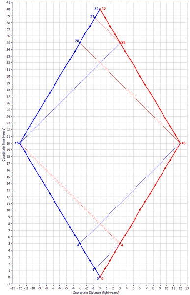

You can verify that both observers see the other ones clock ticking the same way as in the original IRF.

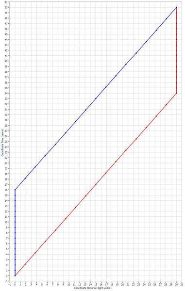

Now we transform to the IRF in which the blue observer is at rest at the end and the red observer is at rest at the beginning:
Still, you can verify that both observers' observations are the same as in the previous two IRF's.

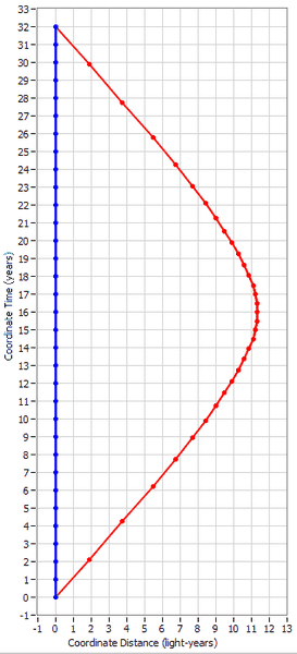

Now if we want to construct a frame in which one of the observers is at rest during the entire scenario, it will have to be a non-inertial frame. There is no standard way to do this but I'm going to show you the way that PAllen mentioned in post #6 which he called radar simultaneity. I have added into the original diagram some significant radar signals that the blue observer sends in blue and the returns that he gets in red. He is also continually sending and receiving additional radar signals during the entire scenario but I don't show them as it would be a very cluttered diagram:
But from all his measurements, he keeps a log and after the scenario is over, he can construct this non-inertial reference frame:
Note that the red observer could have been doing the same thing and constructing his own non-inertial reference frame that would be a mirror image of blue's. The advantage of this type of reference frame is that you can continue to verify the Doppler signals that you verified in the previous IRF's. In addition, there is no issue of reconciliation that you are concerned about.
A fundamental precept of Special Relativity is that all frames are just as valid and none is preferred. They all contain exactly the same information so you could have analyzed the scenario in the initial IRF and be done with it.
Does this all make sense to you? Any questions?

ghwellsjr said:
Your suggestion to make the acceleration be gradual doesn't answer the question--it just changes the problem from one where the other clock is not running slower during the entire trip and instead expands the cluster of dots indicating times 8 through 24 into a finite interval and maybe even encroaching on the dots below and above, but as you pointed out, the problem is symmetrical which means that the Time Dilation in the rest frame that you drew is always the same for both observers and so the answer is that both observer's clocks are always in sync--the problem goes away once you see express it that way.
The 2nd drawing shows there are no missing events that require a "jump" in time, and that there is no discontinuous (non physical) motion. It shows the op that each observer sees both a slow and a fast clock for the other, and graphically demonstrates post#2 by PeterDonis, and that the observations are symmetrical.

Synchronous only in the IRF where they started out at rest and ended up at rest as my first diagram in post #4 shows. In the other IRF's and in the non-inertial frame, they are not synchronous but they all show how the observations are the same.
PeterDonis described a "jump" in post #2:
PeterDonis said:
When each observer turns around, the event on the other observer's worldline that he considers to be "at the same time" jumps forward. So in order to predict what the other observer's clock will read when they meet up again, he has to add in this forward jump to the elapsed time he calculates based on time dilation, as described just above.
And PAllen elaborated on that jump in post #6:
PAllen said:
I think you missed that Peter said that there both of your symmetric observers must model a forward jump in time for the distant clock during the turnaround, in addition to the running slow before and after this. This is a required part of the reconciliation.
Using simultaneity defined by an instantly co-moving inertial observer, you would model that rapid distant clock period all corresponded to your period of acceleration...
I drew a non-inertial spacetime diagram to show this jump in post #17:
However, I have changed my mind on the comment that the "jump" in time is embedded in one dot. Instead, I believe that it is more accurate to spread the dots out in space to correspond to their positions in the two original Inertial Reference Frames that were "patched" together to form the hybrid non-inertial frame for the "instantly co-moving inertial observer":
Note that each dot along the horizontal part of the worldline (except the last) represents two events, one for going to the right and one for going to the left. I have included markings for some of the times to help illustrate this.
The point of this explanation is that it affirms the Time Dilation of the other observer's clock during the entire trip (both departing and returning) but during the instantaneous acceleration, the other observer's clock instantly jumps in time (because the acceleration is instantaneous).
My reason for making this change will become more apparent in my next post.

phyti said:
There are no missing events in the scenario that has an instantaneous acceleration. My previous drawing of the non-inertial frame for the "instantly co-moving inertial observer" that PeterDonis and PAllen described may have given that impression but I provided another drawing in my previous post that should clarify this issue.
As I mentioned before, your explanation with a gradual acceleration of what the observers see of the other ones clock, first red shifted (ticking slower), then no shift (ticking the same), and finally blue shifted (ticking faster) is correct but the same analysis applies for an instantaneous acceleration as I mentioned in post #8. However, the OP was not asking about what the observers could see (even though he misused the word "see"), he was talking about Time Dilation and the non-inertial explanation starts and ends with identical Time Dilation (the other clock ticking slower) but in the middle (at or surrounding the acceleration) there is a time contraction (the other clock ticking faster). This is what PeterDonis and PAllen were both talking about and changing from an instantaneous acceleration to a gradual acceleration doesn't change the explanation that the OP was asking about, it only increases the complexity of the explanation without increasing any understanding.
So to further illustrate this explanation for your gradual acceleration, I have redrawn the Inertial Reference Frame (IRF) for your diagram:
Note that the difference between this drawing and the first one in post #8 is that after ten years of inertial travel, each observer gradually slows down and reverses direction over the next 12 years follow by ten more years of inertial travel.
Also note that even though both observers approach no Time Dilation during the middle of the turn-around, there is no instance of time contraction for either observer.
Now I transform to the IRF in which the blue observer is at rest during the first ten years of inertial travel (and the last ten years for the red observer):
Note again that there is no instance of time contraction, it's all Time Dilation (expansion).
Finally I transform to the IRF in which the blue observer is at rest during the last ten years of inertial travel (and the first ten years for the red observer):
And again, there is no time contraction--all dilation or expansion.

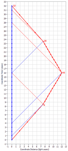

But now we want to construct the non-inertial frame for the "instantly co-moving inertial observer". This is a very complex operation, as I said before. I had to run my application with a different transformation for each event of the blue observer and manually transcribe the events to this diagram:
As you can see, between the two periods of inertial travel, there is a period of time contraction or compression. Gradual acceleration doesn't eliminate the equivalent of a "jump" caused by instantaneous acclereation, it just spreads it out.
But as PAllen mentioned, we don't have to make our non-inertial frame using the above technique. We can also use the radar method and just like in the instantaneous acceleration case, it does not produce the instantaneous jump that you object to.
The way observers do this is by continually sending out radar signals and making a log of the sent times, the received times and the time on the remote clock at the moment of reflection. Here is a drawing depicting the important radar signals:
And from their logs they can draw a diagram that looks like this:
Note the similarity to the last diagram in post #8 for the instantaneous acceleration. And note that there are two periods of Time Dilation at the beginning and ending of the scenario with a period of time compression or contraction in the middle.
And for this type of non-inertial frame, you can drawn in all the same radar signals and/or Doppler signals just like I have encouraged the OP to do for the IRF diagrams. You cannot do this for the diagram depicting the "instantly co-moving inertial observer" which is one reason I don't like that kind of non-inertial frame.
I hope this clarifies the issue.
My mistake. Thanks for your explanations.

phyti said:
post#27:
In a rest frame nothing can move slower, therefore you will not see time contraction!
That's true for an Inertial Reference Frame as I emphasized several times in my previous posts but it's not true for a non-inertial reference frame.
phyti said:
You could save some effort in symmetrical cases like drawing 2 and 3. One rotated 180 ° equals the other. Analyzing the 2nd is redundant.
You can take drawing 2 and load it into Paint and rotate 180 degrees and it will come out the same (with the colors interchanged). I think you meant that you can flip it vertically.
Nevertheless, it doesn't really matter how I produce drawing 3, I did it for a purpose. I guess I didn't make the purpose very clear.
phyti said:
Which case is related to drawing 4 (the nipple)?
As I said, drawing 4 is the non-inertial frame for the "instantly co-moving inertial observer". In order to draw it, I did a lot of copying and pasting. I told you it was a complex process. I started with drawing 2 which was transformed from drawing 1 to a speed of -0.6c. I copied a rectangular block that included the first eleven blue events that were at rest on the x=0 axis along with the first seven red events onto a new drawing. Then I did another transform at -0.5 and copied just one more pair of blue and red events. I continued doing this with transforms approaching a speed of zero and then going in the positive direction and ending with the top eleven blue events and top seven red events. Finally, I connected the red dots with straight line segments. I don't plan to ever do this again.
The reason for all this is to see as the blue observer is changing his speed, what would the simultaneous red events for a bunch of different inertial observer's frames look like that corresponded to each blue event. I'm probably not saying that clearly enough but you can do a search on MCIF (momentarily comoving inertial frame) as PAllen pointed out in post #26 if you want more explanation.
And to repeat, I want to emphasize that even though the gradual acceleration got rid of the instantaneous "jump", there still is a rapid transition in red's events, so much so, that it results in a Time Compression. You can see in the 4th drawing that between the Coordinate Times of 13 and 14 years, 3 years has gone by for the red observer. That sure sounds like Time Contraction to me.

Fig.4a shows the space-time paths in the U frame, using instant speed change for simplification.
Roy moves for 16 days at v=.6c, then 10 days at v=0. Bob moves for 10 days at v=0, then 16 days at v= .6c. Using the radar method, Bob pings Roy's ship periodically and assigns a position using the SR definition of synchronous (divide the round trip time for light in half). One instance is a signal from B10 to R18 to B22. B assigns a position of B(6, 16). The path of Roy according to Bob is developed geometrically over the actual path.
Fig 4b is the result showing the R clock initially slow, then fast, then slow, compared to the B clock.

phyti said:
Here is a similar drawing. Notice R8 is simultaneous with B10 while B is sitting in the U frame, but not after he accelerates. I.e. the emission and detection don't always occur at the same speed.
https://www.physicsforums.com/attachments/65703
I concur with your drawing of the non-inertial rest frame for Bob. And you will note that you have shown Ray's clock as ticking faster than the Coordinate Time, in other words, "contracted". In post #30, with regard to my my drawing of a non-inertial rest frame, you said:
I'm glad you have taken the initiative to make your own non-inertial rest frame drawing and come to the same conclusion.
  • #35
ghwellsjr said:
That would be this drawing:
In this drawing why didn't you assign 16 to the reversal for red?
