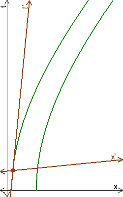

If an observer A hovering at a constant x wants to know his proper acceleration, he can do it by releasing a test particle P from rest and observing its acceleration, relative to him, as measured with his own clocks and rulers. If P is released at rest, then there is negligible difference between the proper times and proper lengths measured in P's frame and those measured in A's frame.
A second hovering observer B at a different height in the gravitational field will disagree with A's measurements due to gravitational time dilation.
An observer C who is not hovering will typically be in motion relative to A and B (except perhaps at one instant in time), and will therefore see additional special-relativistic effects. These effects are the ones that are involved in Bell's spaceship paradox.
[EDIT] Some further thoughts: If the above is correct, then I think I can confirm that your [itex]d^2x/d\tau^2=-a/(1+ax)[/itex] actually does give an acceleration that is independent of x, for the accelerating observer who constructed the Rindler coords relative to himself at x=0. Your calculation had [itex]\tau[/itex] as the affine parameter used for P's geodesic equation, so your [itex]\tau[/itex] is the proper time of P and (approximately) A. Let's say B is lower in the gravitational field, and the Rindler coords are the ones constructed by B. The sign of your equation shows that positive x is up. Therefore B's clocks run more slowly than A's by a factor of 1+ax. A says his own proper acceleration is too small by a factor of 1+ax. But B looks up at A's little experiment and sees the experiment sped up according to his clock, so to him the acceleration seems to be a, matching his own proper acceleration.

atyy said:
Also, Rindler coordinates are not a uniform gravitational field (at least that's what Rindler's text claims).
I think this is right because if I recall correctly, the acceleration in Rindler coordinates is proportional to 1/x.
bcrowell said:
... These effects are the ones that are involved in Bell's spaceship paradox...
I think Ben has touched on an important aspect here and I think the physical implications of the effects should be made clear. If we take an array of accelerating rockets in flat spacetime, all with equal proper acceleration in the positive x direction, such that there mutual spatial separation remains constant according to an inertial Minkowski observer, then the mutual spatial separation of the rockets is continually increasing in the x direction, according to the accelerating rocket observers. By the EP, this implies that observers at rest in a uniform gravitational field will see distances constantly increasing as measured by radar signals and any physical rulers that attempt to remain at rest with the uniform gravitational field will be torn apart. This makes defining distance or even defining what "at rest" means very difficult because distance is always changing over time. Certainly, we can not create a physical grid of rulers and clocks in such a space-time.
