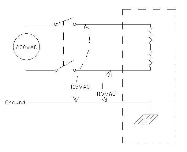

This is what russ is saying about the heater having a 230 volt element.
Oh, the two wires powering the element are the red and black ones you mention.
Not so sure about that schem...if you're showing that source to be 230V, is what you're really saying the attached image?
Because I think that's how you would get 230V, and have 115 between the ground and each of those wires? But that doesn't seem to make sense because you'd really be coming into the unit with at least two 115V wires and a shared ground wire, wouldn't you? And I only see two wires. Is there any way you can help draw it in greater detail, as the way it's depicted in your diagram with a 230V AC source I don't see how you would get that 115V difference to ground...
Ground is not involved in the circuit. It's there as a safety return in the event there's a short from either the red or black hot wires. Evidently you have two individual circuits, one for each hot wire, instead of a two-pole circuit breaker.

What do you mean by "ground is not involved"? Oh wait let me think this through...if they're out of phase, I guess you will always have that 230V across...so the return wire from each of the two sources doesn't lead to the heater, they are just going to ground hence you get that 115V from each hot wire to the ground too. Now it makes sense, thanks!
