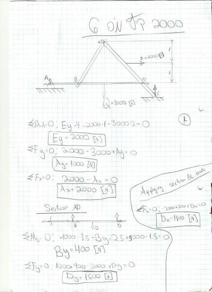

Something strange happening here. I'm isolating the beams (which I'm allowed to do) and I get a different result for Dx with each different beam! Check out what happens when I section it at CE, and check out what happens when I section it at AD
This structure is made out of 3 beams connected by joint. Tip A of the horizontal beam is supported by an immobile support, and tip E of beam CE is supported on a completely smooth horizontal surface. There are two forces acting on the structure, F and Q. The measurements are in meters.
http://img251.imageshack.us/img251/3385/sketch6.jpg
F = 2000 [N]
Q = 3000 [N]
Attached.

In section CE your plus and minus signs are a bit mixed up.
For starters this is the only section where you turn with the clock instead of against the clock.
I would suggest always turning against the clock (the "right hand" rule).
More importantly, in your equation your F turns the wrong way.
Yes, sorry, I feel stupid now-- I forgot to refresh the equation from my absent-minded errors, let me rewrite here the corret equation.
Section CE
Sum of all moments on C = 0 ; 2Ey+1.5Dy-2Dx+2000 = 0
Ey counterclockwise
Dy counterclockwise
Dx clockwise
Force counterwise
That according to all the other calculations
Dx here is even worst then I thought, it's 4200 [N]! Way off the actual result.

Oops, my bad, Dy is the wrong way too.
According to Newton's 3rd law, action=-reaction.
You did draw Dx the other way, but not Dy.

Well, Q is pulling section AD down, meaning Dy on section CE will be down as well.
As a reaction, the floor at E will be pushing section CE up, and effectively section AD as well.
So Dy will be down on section CE, and will be up on section AD.

The forces on a joint always point in opposite directions.
It is similar to when gravity pulls at you, the floor has to push up, otherwise you would fall through the floor :P.
Ooooooooooooooh. I think I get it. Sorry - my intuitive mechanical sense of normal force is escaping me from all these new calculations tactics we're learning. Lovely to see how this connects to pass material, and makes physical sense. So, just to verify, isolating beams, the forces are actually OPPOSITE at the joint when we look at each different beam individually, right?

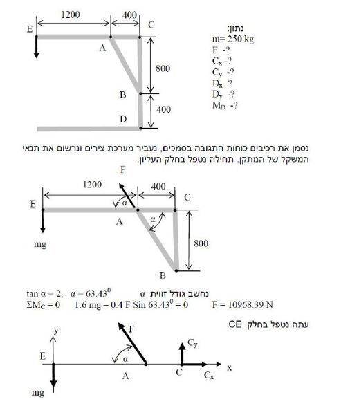

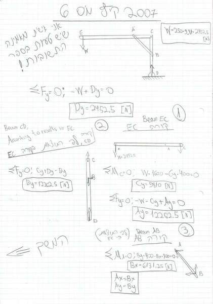

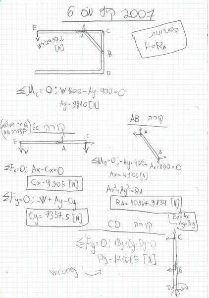

Sorry to harp on the issue, but I've noticed a sharp discrepancy in one exercise with respect to a joint that seems to point at the same direction. IMO, there's a mistake in the exercise.
I uploaded both my solution, and the manual's solution for comparison. The joint I'm referring to is joint B. At beam AB, and at beam CD, it points the same direction.
The engine weighs 250 kg, we need to basically calculate Ay, Ax, Cx. Cy. Dx, Dy, and Md. (in the solution manual, F = Ra). D is fixed, A, B and C are typical pin joints. The measurements are in mm.

Hi golden girl, :smile:
In your section EC all forces and their directions are in order.
In your section AB the forces at A as well as the forces in B should be reversed (because the force in A is a reactive force). The calculation however will come out the same.
Then in your section CD, the forces at B should again be reversed.
Also the force Dy should be reversed.
Note that since Dx, Dy, and W are the only external forces, you can already say that Dx=0 and Dy=-W.
Hi wonderwoman :)
Ah...typical, I made a booby somewhere. I think I got very confused because I didn't see any obvious supports when looking at the structure as a whole. Then I just peeked at the solution and everything went downhill from there. I'm used to the drawing of those half-circle thingies that are attached to the ground. (We call them smachims in Hebrew). Anywho, thank you very much for sorting this out for me! I'll rework the exercise tomorrow, quite tired from solving 10 others, heh.
Thank you dear... ^^
Serena, when I look at the entire first as a rigid body, I understand that I should ignore the reactions are the joints. In that case, where do I draw the force that resists the weight of the engine? Was I correct to pick A? In fact, I didn't quite pick A, I just took it from the solution paper. I'm entirely confused from the picture at which point do I draw the vectors that resist the engine when looking at the construct as a whole. Can you help me see it?
You also say that Dx equals 0, but the answer manual conflicts it.

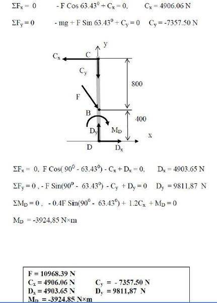

Yes, I'm afraid the answer manual is wrong.
The first page is ok, but the second page contains a series of errors.
Let me list the errors on the second answer page:
1. Everywhere where it says 90°-63.43°, it should be 63.43°.
2. This will result in: Dx=0 N and Dy=2452.5 N (which we already expected).
3. The half-circle drawn near B represent the moment MD exerted by the bottom frame. Note that it is chosen in the negative direction. However in the ∑MD formula there is a plus sign in front of MD, which means the half circle should have pointed the other way.
The external force that resists the engine is the force exerted by the floor on the bottom of the frame. In the second answer sheet this is modeled by the forces Dx, Dy, and the moment MD in point D.
There should be a chapter about support fixtures (smachims?) that explains about this.
It could for instance also have been modeled by an upward force by the floor on the bottom of the frame straight under the engine.
In your own answer you came out on the wrong Dy, because you inverted By.
See, this is what happens when you just copy things from the solution...you get bogged down by mistakes other ppl make. This seems like a fairly simple problem once I understand that D is a fixed support to the ground. Somehow I completely missed that. Thank you again Serena. Let me redo that if you will, I think I can pull it off now.
I found a 4th mistake, the distance between BD in the solution is 400. In the question it's 600.
Never blindly trust a solution book!

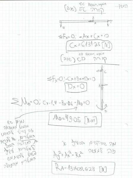

Ugh, I'll tell you why this happened. I started by doing the sum of all moments on A, then I suddenly decided that I don't really like C, that it's kinda ugly and it the corner, and that I like A better (even though it doesn't matter). So, changed it and forgot to change the figures. Ugh, that's why being a girl in mechanics is bad (lol).
I'll rework that.

Oh, and here's my last fix, attached, before I go to bed. All seems to be in order.

Let me give you a few minor parting comments then, and sleep well! :)
On your first page it would look better if you put the MD half-circle in as well, because otherwise the frame would fall over. With the half-circle added, you would show all external forces and moments.
Since you drew Bx on section CD on your first page, you should also draw Cx, to be consistent and to be in equilibrium.
On your second page you drew the moment at D. However as you drew it, it is inconsistent with your equation. You should draw the arrowhead in the opposite direction.

One more thing, on your first page you still mention ∑MC instead of ∑MA.
But for the scores you get the Serena seal of mighty all-physics-like-stuff approval. ;)
