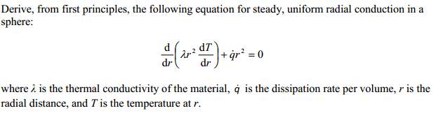

Derivation of heat transfer equation for spherical coordinates
In summary, the problem is asking for the thermal conductivity (λ) in terms of the dissipation rate per volume (\dot{q}) and the temperature gradient (dT/dr) in a spherical coordinate system, where heat transfer is described by the equation dQ/dt = λAΔT/Δr. This can be determined by equating the change in heat flow along a volume element to the dissipation rate per volume, and using the relationship between area, temperature gradient, and volume in spherical coordinates.
eddysd
39
where λ= thermal conductivity
[itex]\dot{q}[/itex]= dissipation rate per volume
qx=-kA[itex]\frac{dT}{dx}[/itex]
I don't know where to start from to be honest, so any help would be greatly appreciated
I've had to think on this one for some time; I hope what I write is correct:
Start with the fundamental equation for heat transfer:
dQ/dt = λAΔT/Δr
where
dQ/dt = Qdot = rate of heat flow across area A;
λ = conductivity;
ΔT = temperature difference across volume element AΔr.
What is ΔT/Δr in the limit as Δr → 0?
Then: what is the volume element AΔr in spherical coordinates? (Heat flows thru the volume element from one side of area A to the other side, also of area A, the two sides separated by Δr. )
Now for the big step: realize that Qdot need not be constant along Δr. In other words, Qdot can be different for the two end-sides of your elemental volume. So in the limit the derivative d(Qdot)/dr can be finite. So your last equation is to equate how Qdot changes along Δr to what the problem calls the "dissipation rate per volume".
OK so this is what I got:
-λ4r2[itex]\frac{dT}{dr}[/itex] + [itex]\dot{q}[/itex]4∏r2dr = ρc4∏r2[itex]\frac{dT}{dτ}[/itex]dr -4∏r2(λ[itex]\frac{dT}{dr}[/itex] + [itex]\frac{d}{dr}[/itex](λ[itex]\frac{dT}{dr}[/itex])dr)
Is this correct?
Since the flow is steady the time derivative [itex]\frac{dT}{dτ}[/itex]=0
But then when I rearrange everything I get:
r2[itex]\frac{d}{dr}[/itex](λ[itex]\frac{dT}{dr}[/itex]) + [itex]\dot{q}[/itex]r2 = 0
can I just take the r2 inside the differential bracket?
EDIT: missed out a dr in the rearranged equation:
r2[itex]\frac{d}{dr}[/itex](λ[itex]\frac{dT}{dr}[/itex])dr + [itex]\dot{q}[/itex]r2 = 0
Your (edited) equation has incompatible terms: the first is infinitesimal, the second isn't. Plus, the terms' dimensions don't agree: the first one's are (using SI) J/sec whereas the second one's are J/(sec-m).
Ironically, your unedited equation has matching dimensions but you can't smuggle the r2 into the d/dr bracket as you wondered. (That's just basic calculus: for example, r2d/dr(r2) = 2r3 whereas d/dr(r4) = 4r3.)
Going back to my "first principles" equation , Q_dot = λAΔT/Δr, you seem to have correctly determined that, in spherical coordinates, A = 4πr2 and, of course, ΔT/Δr → dT/dr. So your remaining task, and it does take some thinking, is to somehow get rid of Q_dot and substitute for it an expression containing q_dot. (Sorry, I haven't learned the itex thing yet). So that you wind up with
-d/dr{λr(dT/dr)} = r2q_dot. That is really the hard part about this problem.
