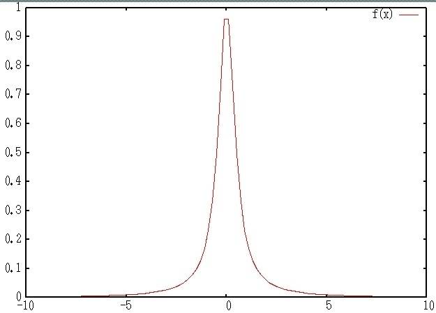

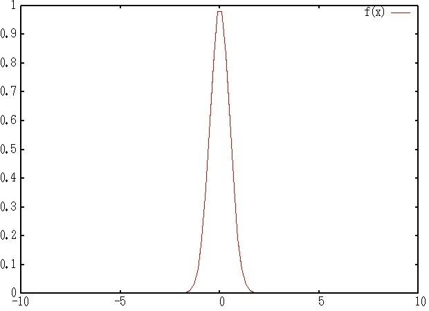

1) I try to understand the lorentzian lineshape and relate to the gaussian graph but i don't know what is the difference.
2) Uncertainty principle- if it's related to the lorentzian lineshape it will give the information about the lifetime in the well and the width of the transmission peak. This has to be applied for one dimensional two barrier of AlGaAs material to find the transmission probability.

1) In general, Lorentzian profiles are related to lifetime and and not Gaussian. Gaussian rapidly touches the x-axis and Lorentzian don't behave like that. I suggest you to plot and see the difference..(if you want i can upload two plots).
2)the FWHM of Lorentzian is equal to the lifetime (please write more information)

Hi,
Loretzian function:
[tex]f(x)=\frac{I_0(\Gamma/2)^2}{(x-x_0)^2+(\Gamma/2)^2}[/tex]
[tex]\Gamma[/tex]=FWHM.
Gaussian function:
[tex]f(x)=I_0\exp\left(\frac{-(x-x_0)^2}{2\Gamma^2}\right)[/tex]
[tex]\Gamma2\sqrt{2\ln2}[/tex]=FWHM.
For both function:
I0=height of peak.
x0=position of peak.
You will find 2 pictures with same height, fullwidth=1 for lorentzian and position =0. For Gaussian fullwidth=1.1774 (=[tex]0.5\times2\sqrt{2\ln2}[/tex]).
Note how the Gaussian function rapidly touches the x-axis and for Lorentzian it is not!
1) The Lorentzian lineshape is a type of spectral lineshape that is characterized by a symmetric, bell-shaped curve with a single peak. It is commonly used to describe the spectral lines of atoms and molecules. The main difference between Lorentzian and Gaussian lineshapes is the tails of the curve. Lorentzian lineshapes have longer tails compared to Gaussian lineshapes, which have shorter tails. This difference is due to the different underlying physical mechanisms that produce these lineshapes. Lorentzian lineshapes arise from a homogeneous broadening mechanism, while Gaussian lineshapes arise from an inhomogeneous broadening mechanism.
