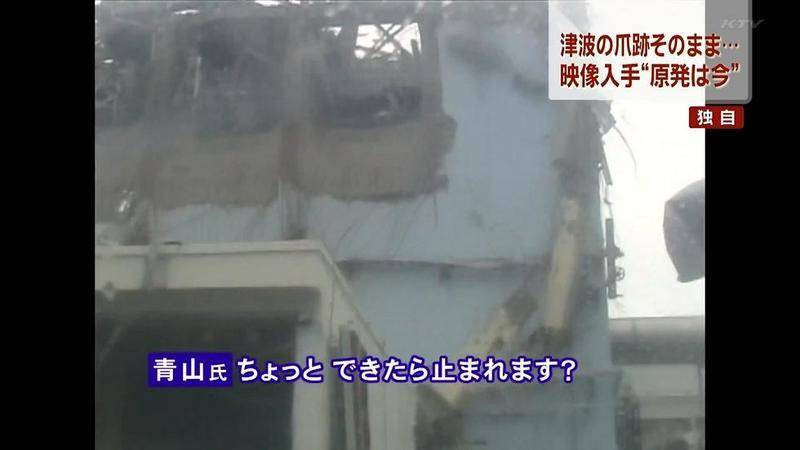

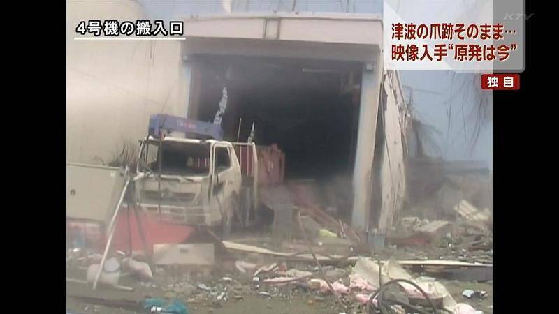

MadderDoc said:
Curiously, there appears to be black smoke and soot evolving at the seaside of unit 4 on one of the most recent Tepco handouts. Right in the middle of the photo. But of course it doesn't necessarily have to be acetylen burning.
[URL]http://www.tepco.co.jp/en/news/110311/images/110415_1f_3_7.jpg
[/URL]
I think its just a shadow of the pipe on the right . T - Hawk video of Unit 4 , 4-15-11
