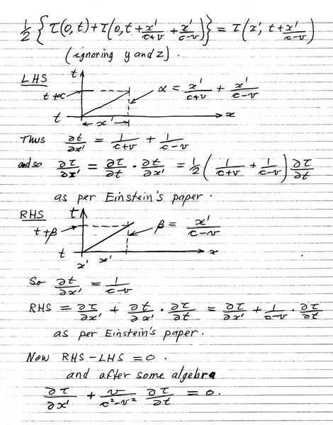

I have read the Einstein June 30, 1905 paper "On the Electrodynamics of moving bodies" but I can't see how he did the following (the
text I've quoted below is on page 6 in my .pdf version):
" 1/2 [ T(0,0,0,t) + T(0,0,0,t + x'/(c-v) + x'(c+v)] = T[x',0,0,t + x'/(c-v)]
Hence, if x' be chosen infinitesimally small,
1/2 [1/(c-v) + 1/(c+v)] dT/dt= dT/dx' + 1/(c-v) dT/dt "
I don't see how x'/(c-v) and x'/(c+v) becomes 1/(c-v) and 1/(c+v) when x' is chosen infinitesimally small.
I can do it by differentiation, eg. dT/x' = 1/(c-v) + 1/(c+v) etc. but I feel he did it by a more fundamental method such as
f'(x) = [f(x + h) - f(x)]/h but I can't see how to use this technique in this case.
Any assistance will be appreciated.
DrGreg said:
See the thread Understanding Einstein's Math and in particular my post #6.
And you could also take a look at my post #4 on this thread where I tried to follow along with Einstein's 1905 derivation, making a lot of implicit steps explicit (the only thing I might change in that post: there was a step where I derived 1/2(1/(c-v) + 1/(c+v))*(dtau/dt') = dtau/dx' + (1/c-v)*(dtau/dt'), the very equation you are asking about, using an argument about zooming in on an infinitesimal region of the function tau(x',t') so it could be treated as a tilted plane, but it's probably simpler to just use the chain rule as explained in post #6 of the thread DrGreg linked to)

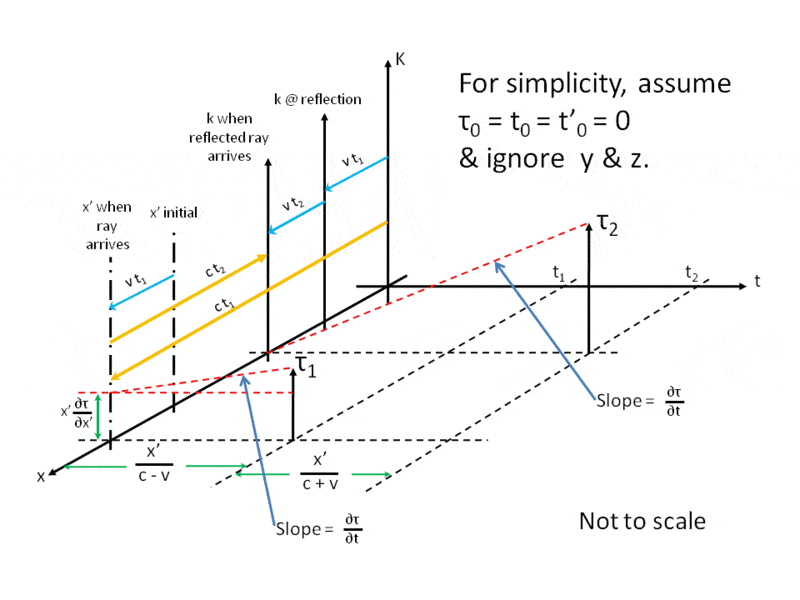

I see that you used X’, Y, Z and T to denote the four co-ordinate variables of which tau is a function. And that Y and Z are zero.
But I don't see how you can do dX'/dx' because, as far as I can see, x' is a point on the X' axis.
I have drawn the attachment to illustrate my understanding of the situation and I can obtain Einstein's maths from it.
Does it look right?

larny said:
I have drawn the attachment to illustrate my understanding of the situation and I can obtain Einstein's maths from it. Does it look right?
Nice and interesting attempt, your graphic. It might help if you add the X-axis (wrt X,Y,Z,tau) and then draw in the light path as it travels in each system.

I showed the ligh paths in orange wrt system K. The orange lines represent both the light paths & the distances.
As far as I can see, in system k, the light would start at X' = 0, reflect at X' = x' and return to X' = 0.
The light path should travel thru the x,t plane. Your orange lines only depict the space traveled for each segment. However, no light path is drawn on your figure.
In system K, the outbound leg needs to go from the origin to the bottom of the vertical Tau1 vector, then the return leg needs to start from there and return to the bottom of the Tau2 vector.
In system k, the outbound leg needs to go from the origin to the top of the vertical Tau1 vector, then the return leg needs to start from there and return to the top of the Tau2 vector.
Also, the Tau-axis should begin at the origin and run thru the top of your vertical Tau2 vector. That's the true Tau-axis for the k system, which intersects the origin. Then you may consider the Tau,t plane to depict the slope dTau/dt.

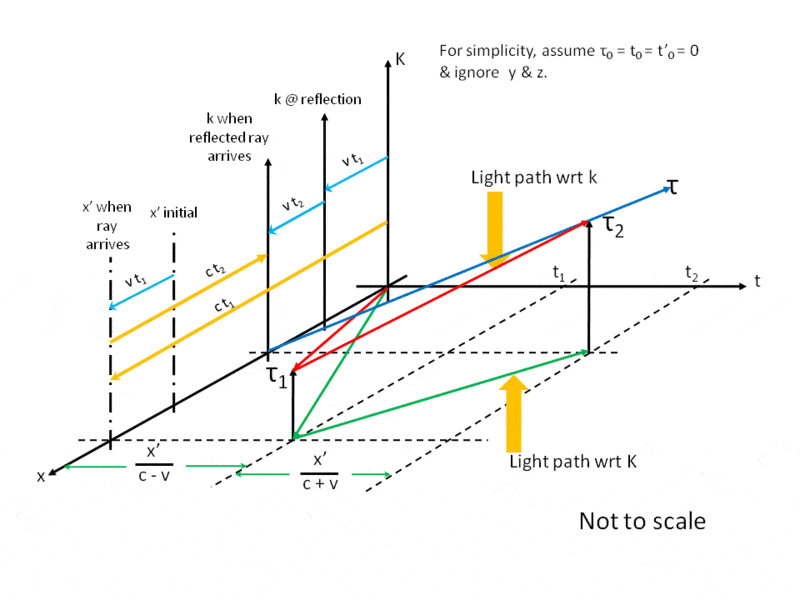

Thanks for the response.
As I understand it, the x & X' axes are co-incident. So why does it matter that I have not shown the X' axis?
My assumption was that the Tau value at any point Tau (x , t) would be perpendicular to the x, t plane & equal to the distance between the x, t & Tau planes. Is this not so?
If not, do they lie on the Tau plane?
I have not thought about the slope dTau/dt yet as I need the answers to my questions & want to be sure the diagam is right first
I have attached my amended diagram. Is this better? Does it still need amendment?

larny,
I see what you've been doing now. You have a mixture of a spacetime diagram and a 2-space diagram (w/time implied), in 1 illustration. I haven't seen one drawn that way for quite some time, so it threw me. Your initial illustration presented Tau, without depicting graphically how Tau1 = (Tau0+Tau2)/2.
In your latest illustration, move the commencement of your Tau-axis to the origin of system K. Because actually, the origin of the 2 systems K and k coincide at t=Tau=0 in Einstein's model, and this is typically the proper way to commence in spacetime diagrams. Leave the other end as is, intersecting the top of the vertical Tau2 vector. Also, your vertical K-axis should instead be called "k at emission", because they are not really axes but rather pointers (which verbiage) points upon the x-axis. Your x-axis should be renamed x,X, which doubles up as 2 axes, one for each system always colinear ... where x and X do not move (in the way you had shown it) in the updated illiustration. Lastly, you could add a dashed line-of-simultaneity forsystem k at time Tau1, which would basically be another Tau-axis (but dashed) intersecting the top of your vertical Tau1 vector, and the X-axis.
You can then add another line that connects the top of the vertical tau2 vector with the point now designated t2 upon the t-axis ... and that'll form the triangle you need within the Tau,t plane to depict graphically the dTau/dt slope.
Wrt your question regarding whether Tau and t are orthogonal, they are not far as how they are oriented in the fullest scope of spacetime (of which we are not privied). They are angularly rotated wrt one another in the spacetime (as are X and x) due to the relative motion. Although it seems that x & X are always colinear, they are not in reality, just as t & T are not and for the same reason. Because we sense time differently than space, we cannot causally observe the relative direction of arrows-of-time. We can only observe the readout of the clock and the relativistic effects (eg time dilation and length contraction), and then reason by deduction that the arrows-of-time are angularly rotated.

Thanks agains GrayGhost.
I need a day or 2 to think through what you & JesseM have written so far.
However, one question.
In space, we know that z = ax + by +c is the eq of a plane.
Now, Einstein's eq for Tau can be written as Tau = gt + hx' where g & h are functions of c & v.
Then, when we "substitute x' for its value" Tau can be written as Tau = pt + q where p & qx are functions of c & v.
So my question is - if the eq for z is a plane in space, then I asume that the eqs for Tau are also planes?
Einstein seems to imply this by his comment "it is clear that the equations must be linear on account of the properties of homogeneity which we attribute to space and time"
I know we are talking about space time, but an equation is an equation, so I don't understand why the Tau "vectors" are not perpendicular to the x - t plane.

larny said:
GrayGhost: I see what you've been doing now. You have a mixture of a spacetime diagram and a 2-space diagram (w/time implied), in 1 illustration. I haven't seen one drawn that way for quite some time, so it threw me. Your initial illustration presented Tau, without depicting graphically how Tau1 = (Tau0+Tau2)/2.
larny: I can't at the moment think how I would do this. However, see my first comment below.​
GrayGhost: In your latest illustration, move the commencement of your Tau-axis to the origin of system K.
larny: Ironically, this is how I drew it initially, but changed it as I thought you must have meant (by "origin") the origin of k because that would make the Tau axis orthagonal to the X axis.​
Your original illustration was a mix of spacetime diagram and a 2-space figure with time implied, all overlaid on a single illustration. While there's nothing wrong with it, it lacks some meaning far as the overall meaning of the theory is concerned. I was trying to figure out a way to make your figure conform more with standard spacetime diagrams. However, it cannot be done in the way that I asked. You're right, the x,X axes cannot remain colinear if you add the Tau-aaxis as I requested. On a standard Minkowski illustration, they are not colinear in fused 4-space, even though they appear as such as they move thru 3-space over time. So, it seems that the only good way to draft it is in standard Minkowski way (or similar), assuming one wishes to have as much meaning on a single page as possible.
Are you familiar with Minkowski spacetime diagrams at all?
