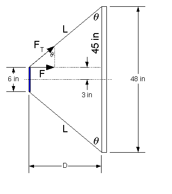

There is a 4ft sq sheet of plywood with an 18" wide rubber band stretched across it. To measure the spring constant (stiffness) of the rubber band a 6" diameter circular metal plate is slipped under the center of the rubber band and pull out taking force readings at 1", 2", 3", 4" and so on from the face of the plywood.
An assumption is that the rubber band is fixed at the edges of the plywood and does not slip off the plate during the evaluation. Additionally, the rubber band is being evaluated within its linear range, before the yield stress (just go with it)
1) Does the spring constant change when (essentially) dividing the spring in half as described above? (i don’t think so because when you cut a metal spring in half the spring constant of the sides does not change)
2) In calculating the stiffness of the rubber band, does the angle of evaluation matter? i.e., does the measured force require a vector adjustment depending on the angle between the rubber band and the plywood? (i don’t think so) he says that:

F=2*s*d*sin (a) meaning that the s changes depending on the distance pulled from the plywood
I say that
F=2*s*d meaning that the s is constant and does not change when the distance pulled from the plywood (good ole’ Hooke)

You should be able to analyze the situation if you start with an appropriate drawing. Here's one that might help:
I think you'll find that the effective spring constant (dF/dD) of the setup will change as D is increased.
Why don't you have a go at writing an equation for the force F in the diagram? You'll probably want to take into account the initial length (Lo) and tension (FT = Fo) in the elastic due to its being stretched across the plywood.

Well certainly hooks law is going to apply, by definition, along the length of the elastics, with ΔL being the change in length of the "spring" element. The geometry of the setup will dictate how the resulting force gets translated into the horizontal direction for any given distance D and thus angle θ.
ok, so going back to your original drawing/post it looks like i may have been using the wrong θ. If i use the θ between F & Ft the results come more in line. But i still don't understand how the eq. gets more complicated.

You need to start by finding an expression for the tension in the elastic segments with respect to the current length of the segment. Using Hook's law that would be
##F = F_o + k_s(L - L_o)##
with Fo being the initial tension (elastic lying flat against the plywood), Lo being the initial length of the segment, and ks being the spring constant.
After that, relate L to the parameters D and/or θ as you wish via geometry. Finally find the horizontal component of F.
right, in my original post i did not step that far back into the linear form and i prob should have. Yes, i understand how that works.
And by using the alternate θ you solved the problem that i was having.
