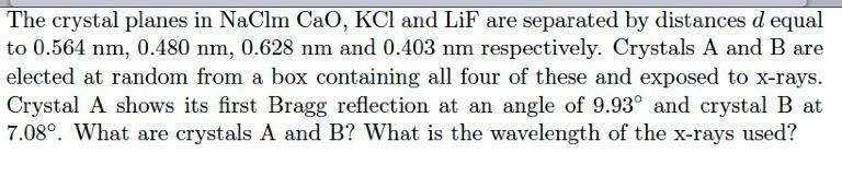

My workings and answer :
TSny said:Looks correct!
