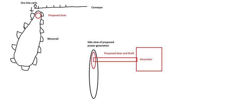

This is a very rough sketch but hopefully it gives an idea.
The monorail is continually moving and around 250 tonnes of ore is transported per hour. No power is required as gravity powers the monorail.
My idea was to fix a chain around the carts that runs over a gear I would install at the top(if anything else would be better I would be very appreciative). Then this directly turns a shaft or if it would be better is geared up to a higher ratio. This could then power a generator of some sort.
I saw the generators wind turbines used and though it looked similar, obviously 250 tonnes pulls down with a lot of force so I was hoping it would be similar to wind blowing blades. They are super expensive but given our power issues and reliance on diesel generators it could be a big help.
Would this even design even work? Is there a much simpler way? I am open to all suggestions.

Pictures like those always put me in mind of PM machines. GPE is independent of path, so the shape is irrelevant.
I found those while I was searching for ideas. I guess as long as the mine is operating it kind of is a PM machine. Well forgetting the power used in the electric powered conveyor carrying the rock up out of the mine :) I just think we could capture some of this potential energy but how much?
If my 13.6kW potential energy could turn a shaft in a PMG it would work. Problem is I am struggling to figure out what size generator would match the GPE figure. I know torque is involved so I am going to keep at it and see if the penny drops.
Use a low RPM multipole generator. As for the torque it depends on the electrical load and the power disappation there-in.

The 'force' needed for a drive shaft has nothing to do with the energy required for continuously operation. MI is largely irrelevant once a wheel or shaft is turning.
The train is already moving completing a full revolution in a minute although this is slowed with a hydraulic system for timing reasons. It also is moving free of any electrical energy. The weight of the objects dropped into the carts is sufficient to keep the whole loop moving. It just goes round and round as if it were powered but it isn't.

I am rapidly coming to the conclusion that a diesel generating set is the right answer for this application. Off the shelf, a known cost and can be sold afterwards. A number of small petrol generators could be even more practical. A bit of lighting and a TV would easily be fed from a 1kW set from a DIY / tool store.
  • #33
Sorry I should have said, the residence block has 1500 people living in it. The site is supplied by mains electricity although lately this has been off more than it has been on. Typically we see cuts regularly through the day but they are short. On a night it is possible to have no mains supply at all.
When the power stops to site we stay running for about 30 minutes through the UPS type thing they have.
Essential processes are powered by generators because that makes money. Workers are left in the dark as we don't matter. We had a generator of our own, probably like the one you are mentioning. It got very difficult though when the supervisors had power and the workers didn't. We took the decision to use it as a sort of emergency light system.
We are now in a kind of all or nothing scenario where either everyone has power or no-one does.
  • #34
danny.mcshane said:
But there will be 16 carts full of 69.44kg of ore all moving down at any 1 time. So the amount of mass being lowered will be 1111.04kg per meter per second.
No, and I have no idea how you combined your numbers to get that value.
250 tons/hour over 20m is 5000 tons*meters/hour, or 1389kg*meter/second.
