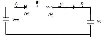

Say D1 is a silicon diode( .7 volts) and D is a Germanium diode (.3 volts)
Determine the voltages at A,B,C and D with respect to ground
You can use hypothetical values
Any help would be greatly appreciated
Thanks

Remember KVL? ƩV=0 around a loop. Apply this fact to solve for unknown voltages.
But the voltage in each point should be the same right even with a resultant voltage?
What about the diodes?

Well let's just say its not that complicated. Let's put Vc as 12 V and Vcc as 24. The diodes are forward basis where D1 is Silicon and D is Germanium. Thats all the details given. Just straightforward.

Sure. Since they're forward biased, pencil in the forward voltage drops for the diodes. What does that leave for the voltage drop across the resistor? (KVL)

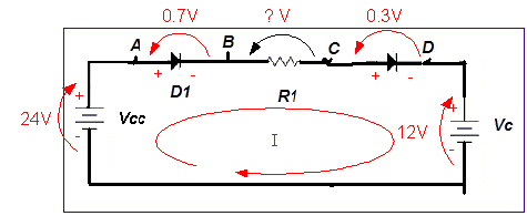

EDIT: Here's your circuit with the known voltages penciled in:

gneill said:
Are you familiar with KVL? Can you write the KVL equation for the loop?
VR = Vcc -.7 -.3 + Vc ?
Almost. Watch your polarity on Vc; when you pass through it on your way around the loop, you're going from its + terminal to its - terminal.
So VR= Vcc - .7- .3- Vc?
Is that a guess? Why don't you explain your reasoning? Take me on a "round the loop tour" of the circuit.
ok well the voltage for the resistor is the Vcc added to the silicon diode. It is in forward basis, so its 12-.7 and then past the resistor into the second diode, again with forward basis, and then the last terminal where it goes from the + terminal to its - terminal into the ground.
Hence reasoning: VR= Vcc- .7-.3- Vc
Well, that's more or less it. For KVL work it's better to deal with individual potential differences across the components rather than the potential at various nodes around the circuit with respect to ground.
So I would say: beginning the loop at point C (at the right end of the resistor) and proceeding clockwise, There is a voltage drop of 0.3V for the germanium diode, followed by a drop of 12V for Vc, followed by a rise of 24V for Vcc, and then a drop of 0.7V for the silicon diode. The sum is then: -0.3V - 12V + 24V - 0.7V = 11V. This remaining 11V will be the potential drop across the final component in our loop, the resistor, bringing us back to point C where we started. Thus the potential drop across R is 11V.

After you've established all the individual potential differences, then you can go back and sum them from the ground node to the individual nodes (you can work in either direction around the loop).
Wait can you show me an example with either point A or B. I am not sure if I fully get what you meant.
Potential at point B with respect to ground: Starting with the ground node and heading to point B: Go from ground through Vcc through diode 1: +24V - 0.7V = 23.3V.
So at C would be 23.3V + 11 V = 34.3 V with respect to ground?
Almost. The resistor has a voltage drop as you pass through it in the direction of current flow. That is, going from left to right through the resistor you have an 11V drop.
So C is 23.3V - 11 V = 12.3 V and D would be 12.3V - .3V = 12V
Just so.
