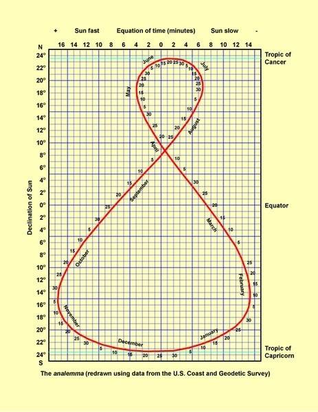

The sun runs "fast" and "slow" during large parts so the the year. See the attached analemma image. And there are times when the slow/fast sun delta times change quickly.
This in combination with your location on Earth's surface changes the times of sunrise and sunset. Add to that the political nature of time zone boundaries and it becomes confusing figuring out apparent - not actual - day length. We live by a political clock.
The actual duration of light is as others have described - from and astronomical point of view.
How we perceive in or day to day lives may be somewhat different.
