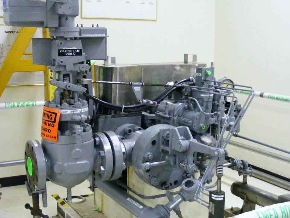

In summary: RCIC consists of a series of pumps, valves, and manifolds that allow coolant to be circulated around the reactor pressure vessel in the event of a loss of the main feedwater supply.In summary, the earthquake and tsunami may have caused a loss of coolant at the Fukushima Daiichi NPP, which could lead to a meltdown. The system for cooling the reactor core is designed to kick in in the event of a loss of feedwater, and fortunately this appears not to have happened yet.
