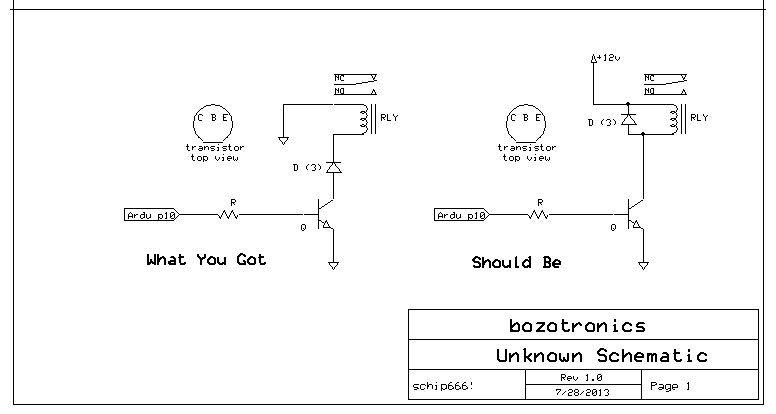

And finally, the second image is a controlling circuit that I do not understand. The device on the left is suppose to represent a 12V relay. The diode is present to prevent voltage spikes from the relay after it has been switched off. My concern is that, given the transistor is an an NPN (BC548), the current would flow from collector to emitter (i.e. to ground in this schematic). The data sheet, and the article, write that the pin orientation is collector, base, emitter. With the diode reverse biased (the cathode is at the relays positive terminal), how does this circuit work?

For #3 I wish you'd post a schematic because I can't follow the breadboard very well. It should look basically like the #1 piezo circuit with a reversed diode in place of the mystery parallel resistor, however on your breadboard it appears that both ends of the relay will be connected to the same power buss when/if the transistor is turned on.
The last image was simply taken from the book, there was no schematic for it. The design is nothing more than a transistor with the diode's anode connected to the collector. The diode's cathode is connected to the positive terminal of the relay. The emitter is grounded and the base is connected to a digital output pin on the arduino.
My concern was that, given the transistor is of type NPN, the current would flow from collector to emitter. This would mean that when the transistor is conducting, the current would be flowing backwards through the diode.
OKokOK You have released my inner pedant... Here's what I believe to be the schematics:
On the left is my reverse engineering of the breadboard. The diode is wrong and the relay power is also wrong. So. I would throw out that book and start over -- BTW what book is it? I hope I don't know the author...hmm...actually I hope I DO so I can razz them -- On the right is my view of how things should work, which indicates that you are on the right track with your work.

It just seemed strange how the circuit was illustrated. The author states the diode protects the circuit by blocking the return path and forcing the current to circulate in the coil to be released as heat. None of it made sense.
The second schematic (right) appears to make much more sense to me than the other.
