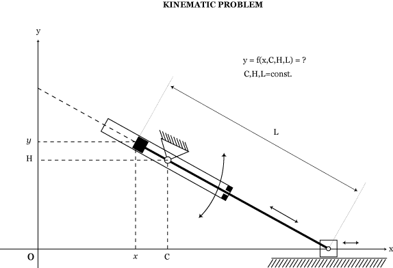

Hey,
Would anyone be able to solve this Kinematic Problem?
At least approximately.
The mechanism in question is a cylinder, piston and a slider. The cylinder is fixed on a pivot in the middle of its body, obviously from the outside.
I have found some approximate solution, but I am not sure if it is good enough.
Thanks in advance,
Atif

I don't understand what is being asked here. All I see is a picture, what are you trying to solve for? I see a couple of equations, what have you worked out so far? The forum has a pretty strict policy conserning showing work before requesting help.
First off, can the attitude. Simply posting a question and then waiting for people to solve your problem for you is not how we operate here.
Next. Formulate a proper question. What are you looking for? From your picture, all I can tell is that you are trying to figure out the path the face of the piston will follow in space.

I have to talk to my dad about what he wanted to find out. He didn't tell me anything. I don't even know what kinematics is. He just told me to post this and ask if anyone can solve this... I figured if he said nothing, it must be self-explanatory. It obivously isn't.
It does appear that he is looking for the position of the piston with the changing values of the dependent variables. However, it is nice to have it stated explicitly.
BTW, kinematics is the process of describing an object's motion without worrying about forces, i.e. positions, velocities and accelerations but no forces.
I think you are right Fred; he is trying to find something like that out?
He told me that the equation is at the top... which he thinks its obivous what needs to be found out. I think I drew the graph badly.. haha... I'm a graphic designer... not a engineer so I haven't got a clue about this type of thing.
Again, sorry for the trouble, and thank you for seeing past my Jackass-ness.
Ok, I think C,H denote the y,x position of the pivot's center, constatn. Find the constants for cylinder width, and radius of rotation around the pivot which will give the dependant variable for the stroke. You should be able to work something out from there.

try this:
Define the angle the cylinder makes with the ground to be theda.
tan(theda) = (y-H)/(C-x)
also
tan(theda) = y/sqrt(L^2 - y^2)
eliminate theda
(y-H)/(C-x) = y/sqrt(L^2 - y^2)
since H, C, L are constants, you have a function of y with respect to x.
