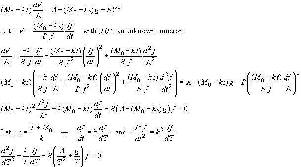

The equation of motion of a rocket with mass depletion during ascent and subject to drag forces can be written as
M(t) dV/dt = A - M(t)g - BV^2 (Eq. 1)
with initial condition V(t=0) = 0 (V is velocity and t is time)
Let us assume a linear mass depletion according to
M(t) = Mo - Kt (Eq. 2)
In Eqs 1 and 2, A, B, g, Mo and K are all constants >/= 0
For the limiting case B = 0, Eq. 1 reduces to a nicely separable form and can easily be solved. For B =/= 0, Eq. 1 can be cast as
dV/dt + p(t)V^2 = q(t) (Eq. 3)
where
p(t) = B/(M(t)
and
q(t) = A/M(t) - g
However, the non-linearity (in V) of Eq. 3 leaves me stuck, since the traditional Variation of Parameters approach does not apply.
Any ideas on how to proceed (in the context of an analytical or at least a semi-analytical solution) would be deeply appreciated.
-Sharat
In attachment it is shown how to transform this non-linear EDO to a second order linear EDO.
(which is related to Bessel functions)

Of course, it isn't a standard Bessel equation. There are a number of variants and the solutions generally are combinaisons of sum and products of Bessel functions with some elementary functions.
I could of course solve the 2nd order linear ODE and substitute f and f' back into the expression for V, but I'll have two constants and only one initial condition.
Or do I apply the condition (f'=0 at T=0 which follows from V(0)=0 ) to evaluate one constant, substitute back into V and apply the same condition V=0 to evaluate the other constant?
The substitution V = ((Mo-k*t)/(B*f))(df/dt) and condition V(0)=0 imply not only (df/dt)=0 but also introduce un supplementary condition :
at t=0 Mo²(d²f/dt²)=B*(A-Mo*g)*f
obtained from the second order linear ODE in which df/dt=0
Preferably, solve the second order linear ODE with two arbitrary coefficients. Then subsitute back in order to obtain the solutions V(t) depending on the two coefficients. Apply the condition dV/dt=0 at t=0 and bring back the found functions V(t) in the initial non-linear ODE. Then eliminate the non consistent solutions, which will determine the appropriate values of the coefficients.

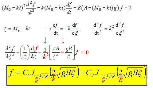

JJacquelin,
Many thanks again for your help. Could you kindly review the attached where I've re-derived the last step (I think you had a k in the coefficient of df/dT in your last equation that should not be there) and compared it to a transformed version of Bessel's Differential Equation from which I get a solution in terms of Bessel Functions of the First Kind.
I apologise for any confusion due to my introducing the variable [tex]\xi[/tex] = -T
I was thinking of using df/d[tex]\xi[/tex] =0 to eliminate one of the constants (C2=Q*C1, where Q is a constant), substitute back into the expression for V whereupon C1 vanishes. Is there something inconsistent about this procedure, that I should be aware of?
Thanks
-Sharat
While it may be obvious, I forgot the = 0 in the RHS of the transformed ODE.
You are right. There are mistakes in my last equation. In your equation too (see attachment)
Better, check once again.
I was thinking of using df/d =0 to eliminate one of the constants (C2=Q*C1, where Q is a constant), substitute back into the expression for V whereupon C1 vanishes. Is there something inconsistent about this procedure, that I should be aware of?
I am not sure that it's so simple.
V(0)=0 implies f '/f=0 which isn't exactly the same as f '=0 since f might also tends to 0 when t tends to 0.
I think that it should be better to keep the two constants, compute f ' and express f '/f as a serie development of t. Then determine the relationship between tne constants so that the limit be 0 for t=0. May be I am too cautious...
