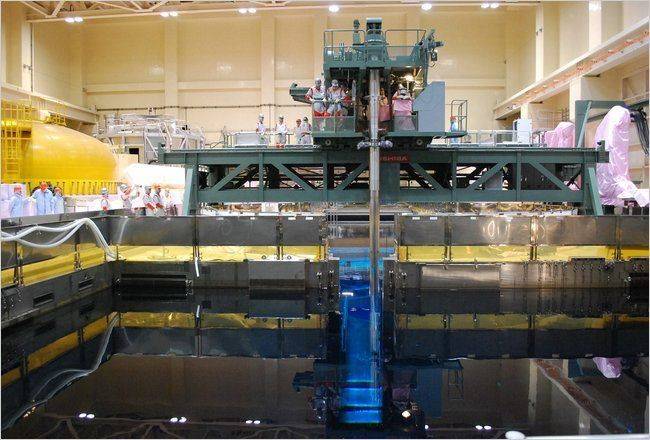

TCups said:
REACTOR ACCESS FLOOR LAYOUT?
Can anyone here add to or correct anything I may have wrong here, please. These are annotated images from drone fly over posted earlier by Fred with what I "think" may be the layout of the reactor access level floors. As can be seen, this will substantially affect how the remainder of the damages might be interpreted.
Blue Rectangle = Pools
Orange Ovals, Circles = Dry Well Cap and approximate positon of Dry Well Plug on floor
Red Rectangle = Building Footprint
Green Rectangle = Lift Shaft
Important points that I am not certain about some basic layout aspects:
1) Are the floor layouts exactly the same in the two buildings?
2) Is there indeed a smaller pool off the side of the SFP between the SFP and Lift Shaft?
Note that the Dry Well Cap has been removed from Reactor 4 but (I believe) would still be in place on Reactor 3. I use it as a relative gauge of the size of where the footprint of the Dry Well Plug would have to be on the floor. Thanks.
ADDENDUM:
I add the "Oyster Creek" Reactor Diagram referenced in several earlier posts.
http://i306.photobucket.com/albums/nn270/tcups/Oyster-Creek-reactor.gif [Broken]
1. BWR layouts out the refuel floors are pretty much standard. The confuiguration you describe is the same as the BWR where I worked.
2. Yes. The cask Pool is an area for loading fuel casks for transfer to reprocessing plants, other storage areas (Fukushima has a common fuel pool storage area), or to other storage such as the dry fuel storage facilities at many US plants. The pool opposite the fuel pool across the containment plug is used to store the reactor vessel head under water when it is open for refueling.
