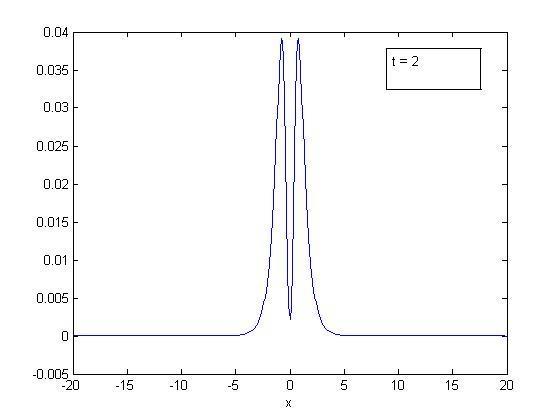

Solving the equation numerically in this way works perfectly except when my time step and position steps are less than 1. For example, for ##\sigma = 4##, ##X_{max} = 200## (but x runs from ##-X_{max}## to ##X_{max}##), ##T_{max} = 400## with ##\Delta t = 0.1##, ##\Delta x = 0.1## and an initially Gaussian profile centered on x = 0, on the second time step the Gaussian peak develops a split in the peak (image attached), which should not be there - the Gaussian should of course just be smoothed out. The split peak propagates for a while until everything is smoothed out. For time/position steps greater than 1, the split does not occur and the solution behaves as expected.
EDIT: I think the resolution to this error might be that I did not notice that I should be using timesteps ##\Delta t ~ (\Delta x)^2##. Using timesteps of the appropriate order seems to resolve this issue, but not the issue discussed below.
