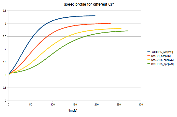

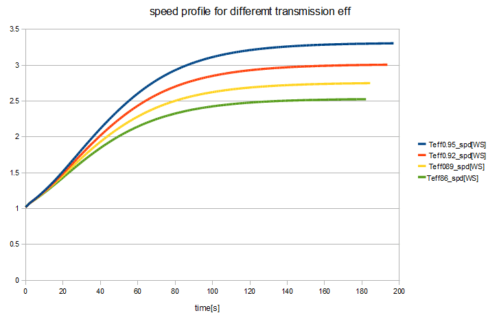

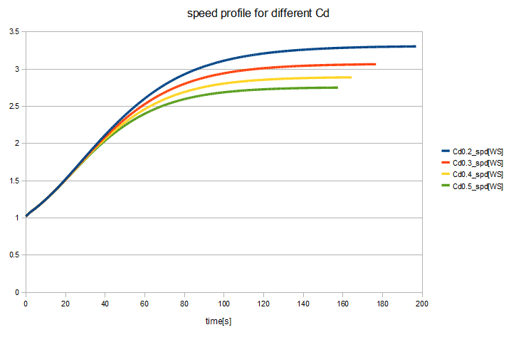

Oh! I never thought of that. Quite a while back, I ran a computer simulation on the device from a standstill, and it only reached 70% of wind speed. Though it was a fixed prop pitch simulation. It appears that the full scale model has variable pitch blades. Back to the drawing board.
  • #50
RCP said:
With spork on board we are talking about over 600 lbs.. Couldn't it store a lot of momentum under the right conditions getting up to ws? If a tin can will exceed ws for a few seconds in a lull after a gust, wouldn't BB be capable of doing so for ten seconds or more?
RCP, if you'll try to remember (or even read the NALSA rules again), you will see that during the 10 second timing period the BB cart had to be *accelerating* -- that is it had to exit the timing period *faster* than it entered. The tin can that is beating the wind during a quick lull is doing *just the opposite* -- it is slowing down.
The requirement for acceleration through the timing period was added *precisely* to make it impossible for the BB to 'coast' through a lull to get the record.
so might it not be in the realm of possibility they got some things wrong?
Like what?
I would still love to see how I Ratant's cart would do on a treadmill after seeing that popcorn sail past it in natural wind. And remember, he was clever enough to design a cart that had remote steering and could ride the wind without needing a guide wire.
OMG RCP -- "clever enough"? You think the reason we didn't put RC on our small model was because we weren't "clever" enough?. That's freakin' funny. ROFLAO. Goodman put RC on and was accused of using the battery that was onboard to power the cart. THAT'S why we never made one RC. We wanted to be able to say correctly that there were no batteries on board at all.
But then you've known this over and over -- you just can't keep it all together.
JB
  • #51

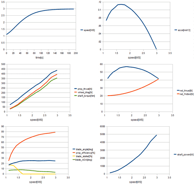

Their first prototype had fixed pitch and went above 2x windspeed from a standstill. but the acceleration below windspeed was very low. Maybe your pitch was too high, the wind too low or the assumed inefficiencies worse then in reality. The self start is not really the key claim here anyway. The core question is if it can achieve a steady state above windspeed.
How did you calculate the propeller axial force and reaction torque below windspeed? I did some simulations using http://www.mh-aerotools.de/airfoils/javaprop.htm" libraries (propeller simulation based on blade element theory). This software cannot really handle the the situation at windspeed(zero airspeed) very accurately so I started the cart just above windspeed. I used the actual propeller geometry of the Blackbird and with the folowing parameters:
transmission eff: 0.93
aero drag coefficient: 0.22
rolling drag coefficient: 0.01
frontal area[m^2]: 2
mass[kg]: 295
it went close to 3 x windspeed in 4.5m/s wind.
WS = true windspeed
wheel_drag = retarding force on wheel needed to turn the prop
net_thrust = prop_thrust - wheel_drag
net_friction = aero_drag + rolling_friction
The pitch was variable and adjusted for best acceleration (see blade_angle bottom left)

mass[kg]: 295
Since the efficiency parameters are estimates I also checked the sensitivity of the result to those parameters:
Most embarrassing. I searched for over 2 hours yesterday and could not find the simulation. But anyways, it's moot point, now that we know my prop pitch was incorrect.
  • #54
OmCheeto said:
Way too high according to your chart. I had a pitch of 45 degrees, based probably on what I could visually observe from the original mini-carts.
The plotted angle is the blade angle at 75% prop radius. Since the blade is twisted it is much higher closer to the root. The transmission ratio between propeller_omega and ground_speed plays also a role here.
  • #55
