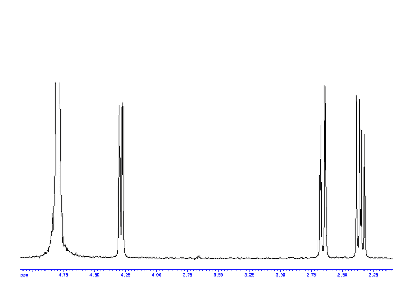

Thank you for the quick reply! I have an H-NMR of Malic Acid and am having trouble understanding it and cannot analyse it properly. How can I determine the structure of Malic Acid (HOOCCH2CH(OH)COOH) from this graph? Does integration and peak numbers have anything to do with it?. Below is the spectrum of Malic acid. I'm lost when it comes to these graphs. It was sourced from:(http://bmrb.wisc.edu/metabolomics/mol_summary/show_data.php?id=bmse000238&whichTab=1 and http://bmrb.wisc.edu/ftp/pub/bmrb/metabolomics/entry_directories/bmse000238/nmr/set01/spectra/1H.png)

Peaks, or environments? Each of the protons is different in malic acid, so feasibly you could see 6 different environments.
How would you determine the structure of Malic acid from the NMR above?
In short, I probably wouldn't, at least not in isolation. I may have an inkling of how my unknown was made, or other spectral data. Also, in 1H NMR these are usually integrated, which may also give a clue.

Thanks for the answers! I apologise if I seem repetitive, but this stuff genuinely stumps me. How could you integrate this graph? Is it even possible for this to be done on this particular graph? Again I apologise if I'm repetitive, but I need help. Thank you.
