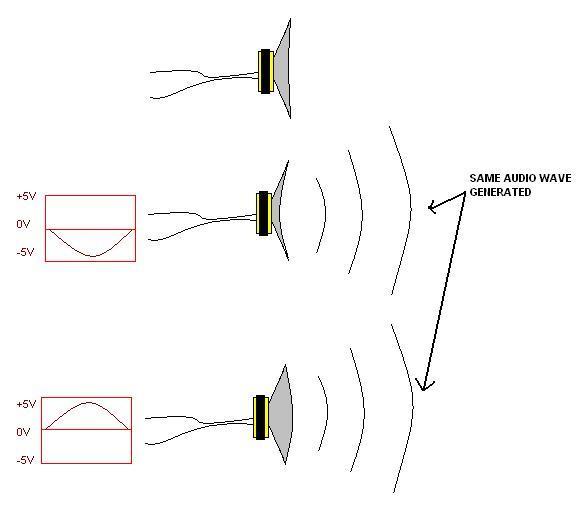

I played the audio song on my 8 Ohm audio speaker. I used my Computer Audio Port to play the song. I played that song on my speaker, it worked perfectly, but when I invert the audio signal 180' out of phase, the voice generated was the same.
That is to say, when the speaker used to contract, it was expanding and when the speaker used to expand, it was contracting, but there was no difference at all in the sound wave generated, why was this happening?

The speaker creates pulsations in air pressure. In practical terms, it make no difference whether the speaker's voice coil initially retracts or extends when a note is hit, though I expect that some audiophile with $1000 speaker cables is going to challenge this. I have rebuilt and restored guitar amplifiers for many years, and when dealing with an amp with multiple speakers, I always observed speaker polarity to avoid cancellation effects. With single-speaker amps, the owner could never tell the difference if polarity was observed or not.
it sounds the same, but it is not the same waveform. if they're driven by a sinusoid, one waveform will be 180o out of phase from the other.
the reasons why it sounds the same are largely physiological and psychoacoustical: our hearing is essentially polarity insensitive. (not relatively between ears, if you reverse the leads on just one speaker of a stereo pair, you will notice a problem, but if you reverse the leads on both speakers, you will not hear the difference.)

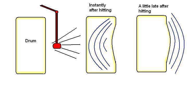

When a drum is hit, the surface that is hit moves in. But the surface on the other side moves out. So why don't they cancel out and no vibration should be produce.Condensation and rarefaction don't cancel out. Is that the reason they don't cancel out, because they are on opposite sides. As depicted in the below diagram.

Written by: Kral
There is disagreement among audiophiles as to whether it matters whether there is a phase inversionin the playback system or not. Certainly for steady state sine wave tones, it does not. However, consider this situation: You have a drummer whack his bass drum once. In the live scene, the initial wave reaching the ear is a pressure (higher than ambient pressure) wave. This is then followed by a rarefication (lower than ambient pressure) wave. If the audio reproduction system has a 180 degree phase shift anywhere along the signal path, then the initial wave reaching the ear from the speaker will be a rarefication wave, followed by a presure wave. Does this matter? This is the question that creates controversy among audiophiles. Some say they can hear the diffrerence, others say no. Certainly for most music, you will not be able to hear the difference (my opinion). It would be interesting to perform a double blind test with the bass drum or some other percussion instrument as the musical source material.

umery2k75 said:
When a drum is hit, the surface that is hit moves in. But the surface on the other side moves out. So why don't they cancel out and no vibration should be produce. Condensation and rarefaction don't cancel out. Is that the reason they don't cancel out, because they are on opposite sides. As depicted in the below diagram.
you need to set up the thought experiment better. of course they don't cancel out except conceivably latterally from the drum where the compression wave and rarefraction wave have the same distance to the listening ear.
think of one monophonic amplifier driving two identical speakers but only one is wired with the polarity reversed. along a plane that is halfway between and perpendicular to the line connecting the speakers, theoretically the waves cancel out. but not at other locations where the distance to one speaker is shorter than the distance to the other.
