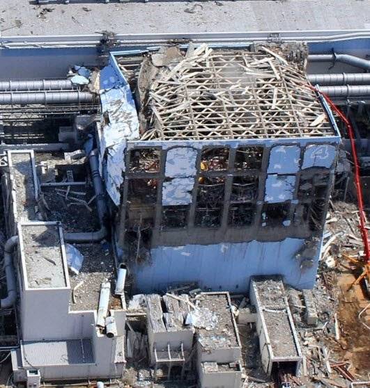

Look at this photo of the severe damage to one of the fukashima reactor buildings (I'm not sure which one) and tell me that the containment structure and/or reactor vessel have not been severely damaged? Judging from the photo, 3/4 of the reactor building has been obliterated. Nobody is saying anything about the condition of the reactor core of this unit. The other three reactor buildings appear to be in much better shape.
Apparently unit 4 is having the most trouble according to the news.
[PLAIN]http://www.panorama.com.ve/21-03-2011/avances/fotos/fukushima680.jpg [Broken]

I would say this picture is a poor representation of the condition of the reactor containment vessel. Yes the top of the building looks to have been blown off, but I'd say the RCV should have survived that. I would be more concerned about the spent fuel rods.

Why do you say this? Are you an expert in reactor design? Are you there with the current TEPCO workers attempting to completely end this incident
Hi,
What you see as severly damaged is the upper structure above the containment building, not the reactor itself.
Here is a good starter on BWR reactors, and on page 16 you see a schematic of the building.
http://www.nrc.gov/reading-rm/basic-ref/teachers/03.pdf

My concern is not for the portion of the building that is exposed and damaged, but for the structure beneath the core itself. I am sure that it is several feet thick of steel and concrete but is there any possibility of there being small breaks in the structure that could allow contaminated water to leak into the groundwater? If that is the case could capping the reactor in boron/concrete resolve this or would the leak need to be sealed from below?

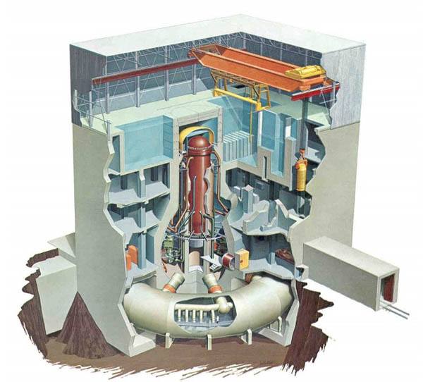

When you compare this technical diagram of the Fukashima reactor to the image in the OP, the reactor containment building should be visibly sticking out of the center of that obliterated reactor building. But it is not, meaning that it has been severely damaged or even destroyed.
The other three reactor buildings are in much better shape.

Yes, but comparing it doesn't mean anything if you aren't on the ground to see for yourself.
The pictures do not give an actual portrayal of what has happened to the RPV. Everything you're saying is pure speculation.

I'm sorry, what exactly caused the reactor buildings to explode again?...
Hi Fishman,
1. The reactor building itself did not explode.
2. The weather shell above the top of the reactor building was blown out.
3. Theory is that this was due to a hydrogen explosion on the upper level.
1. The picture's contrast was turned way up (check the sky). That's unfortunate, we cannot tell whether the "smoke" is black, gray or white.
2. If any fuel is critical, it is because a substantial amount somehow collected somewhere, away from the control rods and/or boron-doped storage sleeves. To control it again one must get boron *inside* this mass, between the fuel bits. Boron on the outside has no effect at all. If the fuel is in a compact mass, I can't see how...

...When you compare this technical diagram of the Fukashima reactor to the image in the OP, the reactor containment building should be visibly sticking out of the center of that obliterated reactor building...
The photo you used of the destroyed unit 3 that looks like it's burned to the ground is an optical illusion. The brown ground in the photo is actually a hill that obscures the lower part of the building. (I was fooled by this myself and thought the same as you. I thought the reactor had been blown to hell, judging by that photo.)
[PLAIN]http://news.sirfpaisa.com/wp-content/uploads/2011/03/Fukushima-Daiichi-nuclear-power-plant.jpeg [Broken]Here's a different angle:
[URL]http://images.publicradio.org/content/2011/03/16/20110316_fukushima-daiichi-nuclear-complex02_33.jpg[/URL]
Notice the height of Units 1, 2, 3 and 4 appear to be the same accounting for the angle that the photo was taken and such.
It also appears that Units 3 and 4 weren't built exactly like Unit 1 or like the cutaway diagram of a BWR Mark 1. Notice Unit 1 on the left in the photo above. It's got the blowout panels for the top two or three floors sort of like the cutaway diagram. Steel girders and metal panels.
[URL]http://modernsurvivalblog.com/wp-content/uploads/2011/03/general-electric-boiling-water-reactor-mark-I.jpg[/URL]
Yet the top floors of Unit 4 have concrete posts:
[URL]http://4.bp.blogspot.com/-Ca-0hEixr4Q/TZfRXsrkq2I/AAAAAAAAAzg/PWaH4D9OFT4/s1600/fukushima.jpg[/URL]
That's definitely the top since the bridge crane would have to be under those roof supports.
So it looks like Unit 3 was built like 4 and the top floors would be where the bridge crane was.
[URL]http://images.ctv.ca/archives/CTVNews/img2/20110322/600_fukushima_unit_3_reactor_ap_110322.jpg[/URL]
Still, you look at this next photo and you have to wonder what damage the reactor vessel took:
[PLAIN]http://img.ibtimes.com/www/data/images/full/2011/04/01/81459-fukushima-daiichi-nuclear-plant-aerial-view.jpg [Broken]
i agree that is very troubling.
