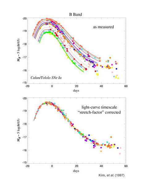

The biggest non-standard candle-ness of SN can be nicely removed by a process known as 'stretch correction'. This where there is a relationship between the SN peak brightness and the light curve width (how long in days it shines for). Once the light curves are corrected for redshift (redshift stretches the light curve out in the same way as it stretches the light wavelength) they look like the top plot in the attached figure. Note that the peak brightness of them is all quite different. However, once a simple scaling is applied to the the brightness as a function of light curve width, the bottom plot is achieved. These stretch corrected light curves are then remarkably standard. Note that this stretch correction is an empirical result. It appears to work even though we don't have a great idea of the physics behind why it works. This is a gap in knowledge that a lot of theoretical work and low redshift SN observations are working to solve.

This is very cool. I understand that the redshift should also apply to the duration of the SN. I'm assuming that it is stretched in the same way a photon wavelength is stretched, hence redshift...
...This result is interesting. When we apply this algorythm to the graphs, are you saying we're not entirely sure why the match is so good? Does this relationship (the change from the original to the stretched fit) imply some fundamental property of SN that we are now attempting to unravel? I guess what I'm asking is wether the relationship of peak lum. vs. duration may imply some kind of physical property about SN that we are trying to understand, hence when we stretch-fit the data in this way, it fits remarkalby well? Can we learn more about the nature of SN by analyzing this result as a clue to something? Sorry for rambling, I've always been fascinated by Super Novae.
This is starting to reach to the edges of what I am sure about, but I will answer the question as best I can, and hope I don't mislead you!
The stretch correction process certainly indicates that there is some physical mechanism in the Supernovae explosion that leads to this correlation. I believe there is some relationship between the stretch correction and properties of the SN spectra, in particular the strength of some metal lines, particularly Nickel. The strength of the line tells us how much of that metal is present in the SN progenitor (the thing that the SN is before it goes boom) and I think it is the different metal abundance that regulates the peak brightness and width. This is another reason to doubt that high redshift SN1A are different from low redshift ones, since we can observe these abundances in both cases.
Fascinating. Thank you for the extensive feedback with all of this, Wallace. It's great to get straight feedback and insight regarding the technical side of these things. I will keep a close eye on Super Novae research from now on!
Cheers All.
No worries. There is a project underway at the moment dubbed 'the nearby supernovae factory' (or something like that) which is aiming the look in detail at hundreds (possibly thousands?) of SN1A in the low redshift Universe. Since they aren't looking at the distant stuff they can do it with a small telescope ( I think it is only ~1m) and get lots of observing time, since small telescopes aren't so sought after. You can't do much cosmology with these local SN, but they hope to get a much better understanding of them in order to better inform observations of the high redshift ones. And of course just to understand these SN in their own right!
