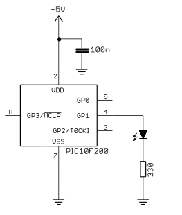

Hi forum!
So I was trying to learn how to use PIC
In the tutorial,they said I should add a bypass capacitor between power supply and ground.
But will the whole thing shorted out because of this connection?Why or why not?
ahh,I see,thanks!
